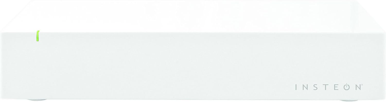

The thing I don’t see is a PLM, although I didn’t look very throughly. What you can use in its place is an insteon hub. The openHAB PLM binding works both the PLM and the hub.
That is exactly the problem. There is apparently no Insteon controller on the European market at the moment (at least for Germany) which makes it impossible to test this technology.
Is the hub also dual band?
Would this work in Germany? I believe it is supported in openHAB:
It is a device designed for the UK market. I searched the net and found that is uses different power cords than we have in Germany.
Right - but I’m thinking should be same voltage, there should be a little physical converter to go from UK to DE style plugs. I think this would do the trick right?
Ok, if it is really as easy like that? Just juse a travel power adapter and it works? I am a bit concerned why there is so little official market support from Insteon in Germany. However, it sounds interesting and perhaps I’ll try it with the UK version.
Cool, let us all know how it works out for you!
