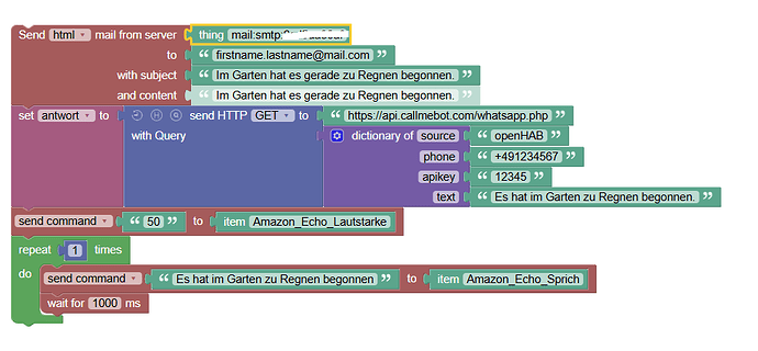

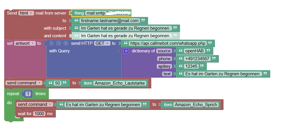

I’m using the Amazon binding for a lot of stuff.
One example is, that my Echo tells me, when it has started to rain outside.

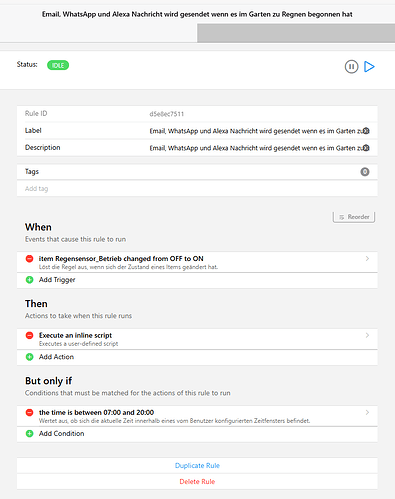

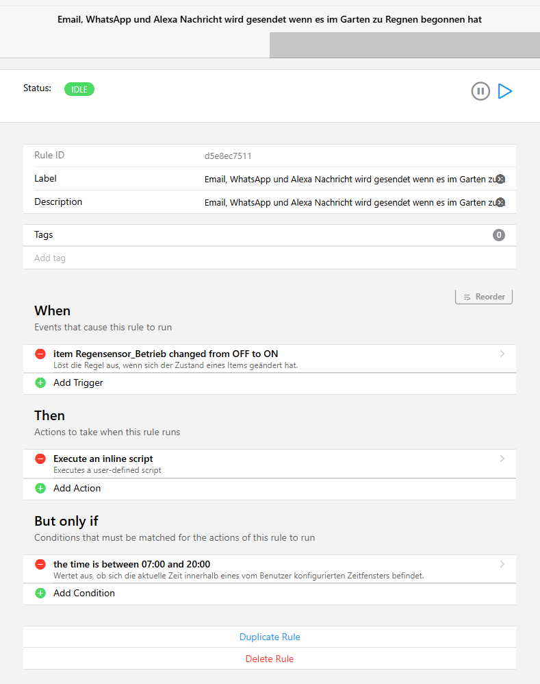

Technical wise I have a rainsensor which has an open try contact, and closes the contact
from his relais when it get wet. This sensor is connected to a Shelly 1 which is also included in the OH 5.03 installation.
If this shelly gets a change of his channel for the “usage”, this is used for a trigger for a rule,
which sends me a voice notification, that rain has started.
Here is the rule which I use for Email, Whatsapp and Alexa in this case.
And here the Blockly script for the execution:
I hope this helps to get some scripts for the Alexa for you.

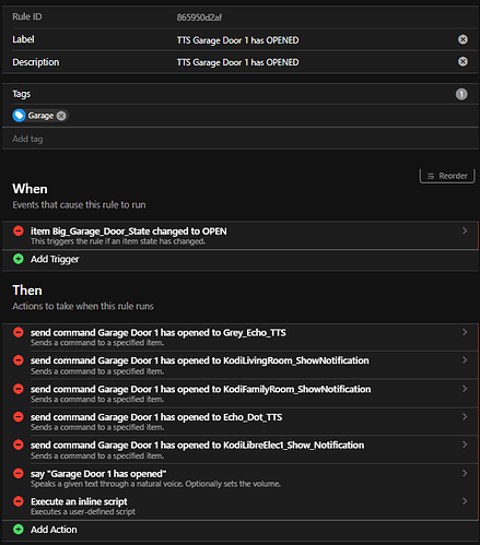

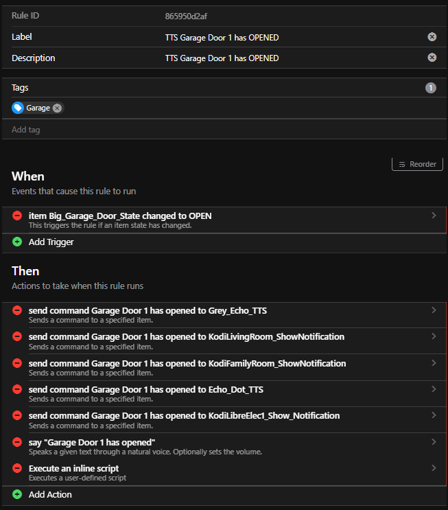

I use the amazon text to speech for a few notifications. Below is how I’m creating a notification when a garage door opens that uses the string channel of an amazon echo thing as target (among others). No reason why you couldn’t do the same for a connected doorbell.
I also send a similar notification to my default audio sink (a sonos speaker) and a few kodi instances. But you get the idea. It’s pretty simple with the echo string channel.

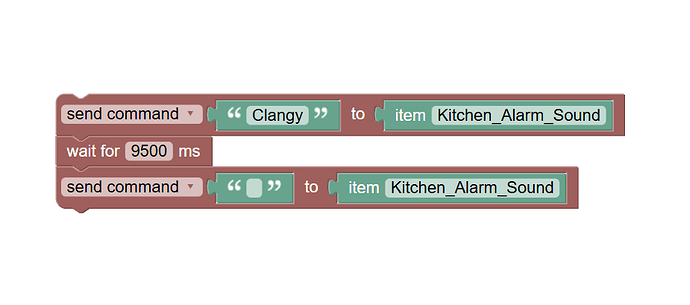

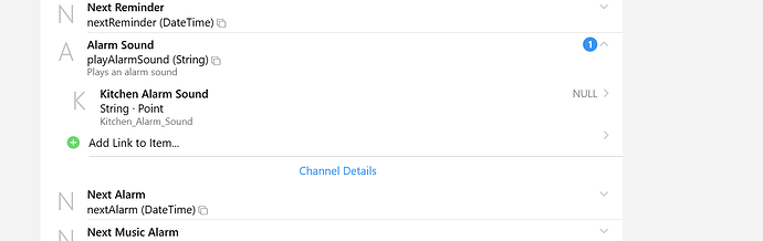

Just to close the loop on how I got it to work
Install the Amazon Echo binding and authenticate the bridge. I set discovery to “
Direct, over Alexa and openHAB skill”

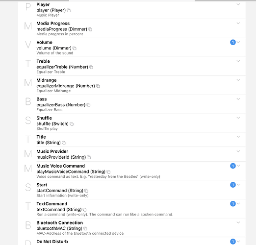

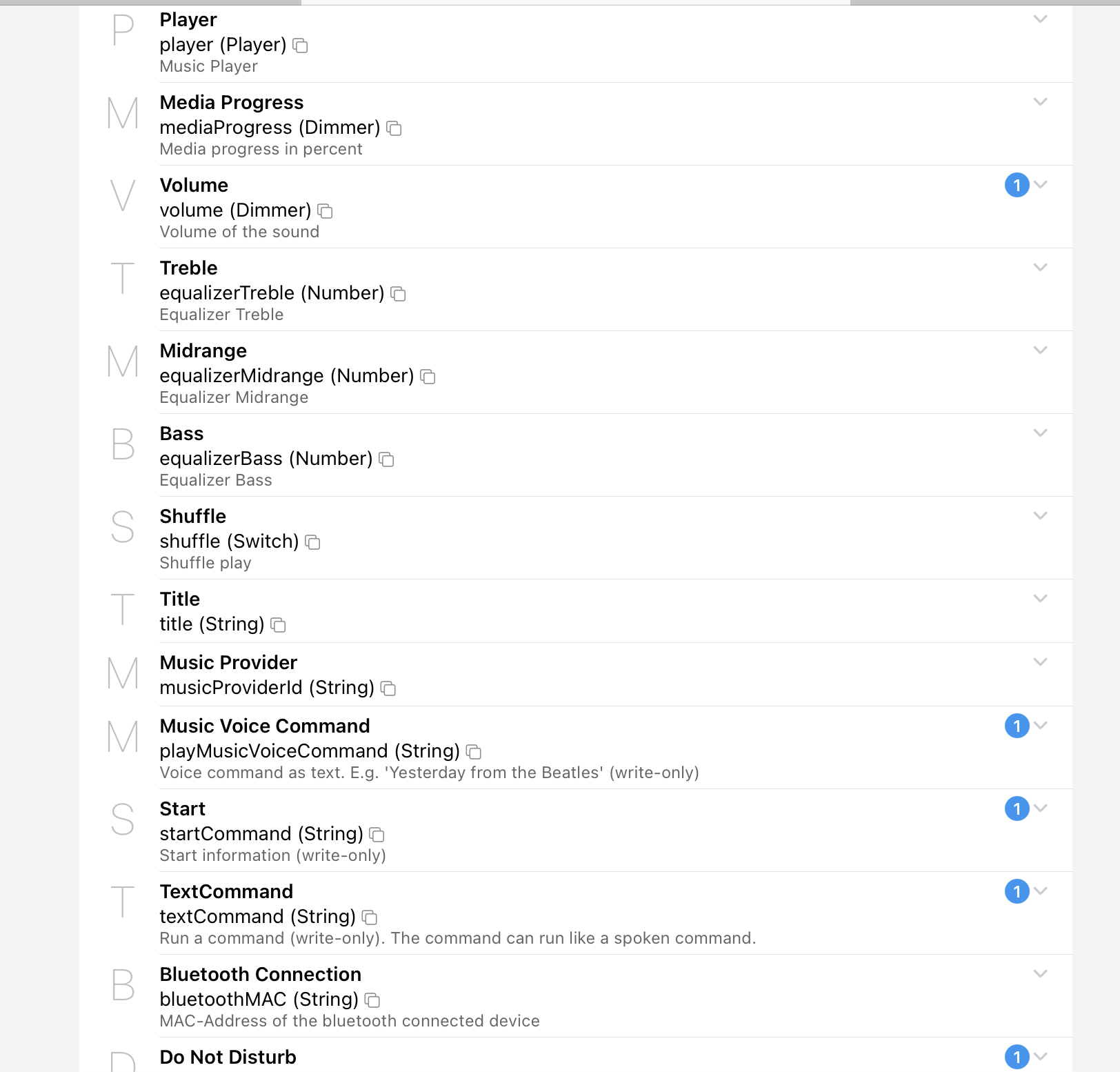

Go into CHANNELS on the Echo Device and click ADVANCED.

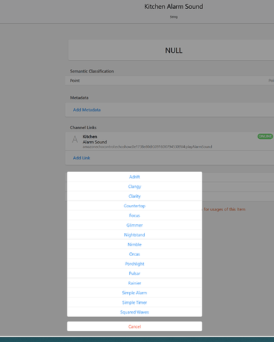

Create an item for the Alarm Sound.
The Item will helpfully show you a list of sounds it knows how to make.
Below I show an example of a Blockly script that plays out one of the sounds. You have to type in the string name of the sound you want to play. The Alarm plays continuously on my Alexa until it’s cancelled. The Blockly script shows playing the sound and then cancelling it with a null command after a few seconds.
In my setup it takes 5 or 6 seconds for the alarm to start playing which is a bit slow for a doorbell.
