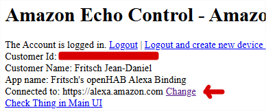

Have you done disconnecting and reconnecting the bridge under
http://your_server:8080/amazonechocontrol/ ?
It was changed to https://eu-api-alexa.amazon.com, so maybe the .fr server is not reliable anymore.

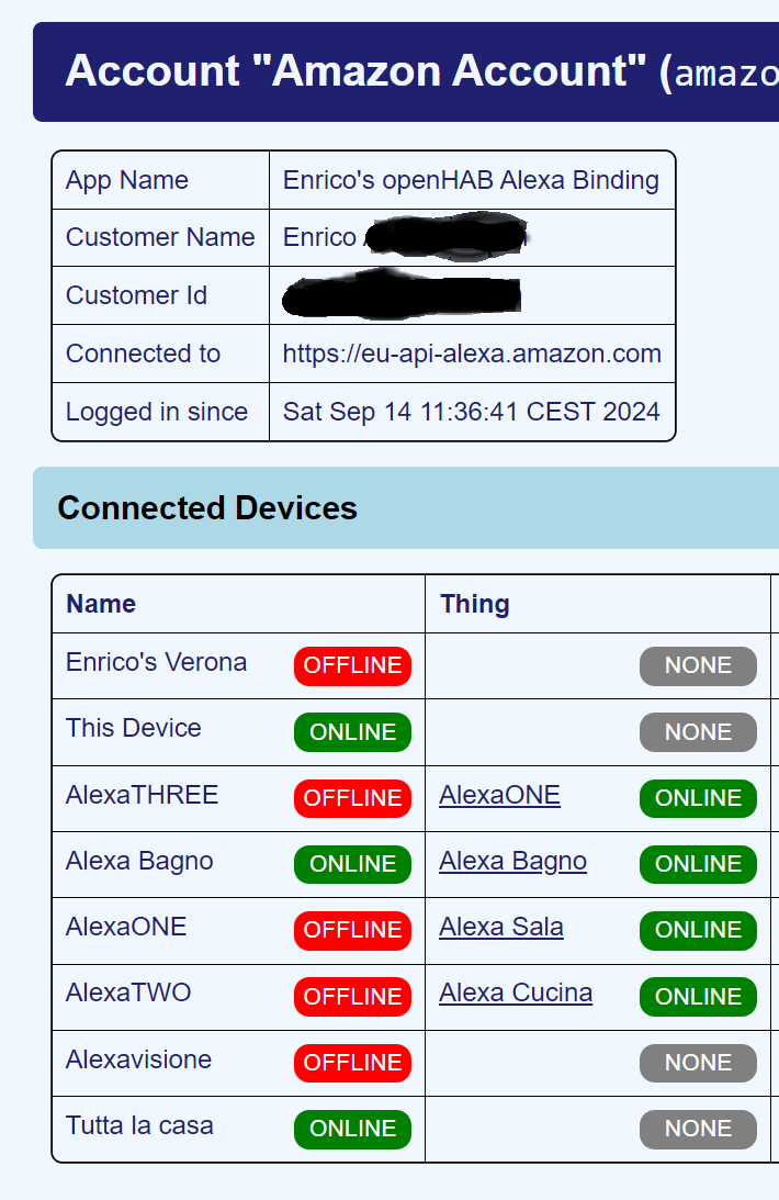

But my detected Things were still OFFline
Changing back to FR, the binding is Online and my devices are found - hope it is foreever…
Now ā€œonlyā€ SmartHomeDevices are not recognized

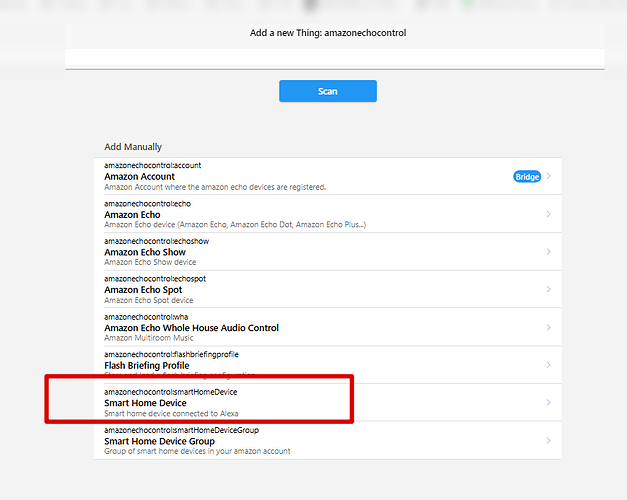

Hi Jd,
With SmartHomeDevices you mean a light that is connected to alexa and you want to turn on and of from openhab thru alexa binding?
Here same problem i try to manually create things… but there are no channels.
I also noticed that if I unplug an echo. for the binding still remain online.
No,
SmartHomeDevices are devices liked in Alexa using other skills like Broadlink or SmartLife
compared to ā€œechoā€ devices

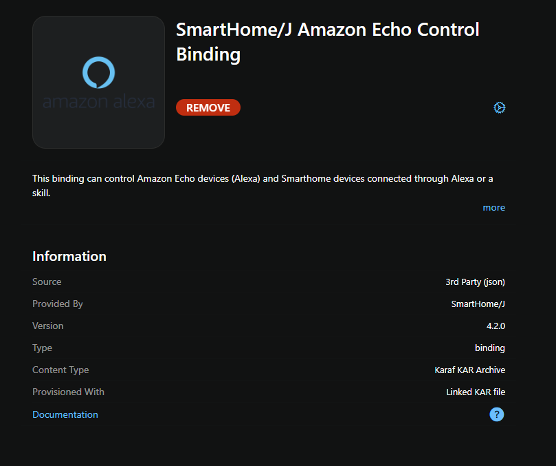

OH 4.2.1
SmartHome/J Amazon Echo Control Binding version 4.2.0

But do you have ā€œlogout and re-registerā€ at the very top right? That’s the one you need.

There is a way to understand if there is an update of the plugin?
The only way i found is remove plugin reinstall and bundle:list

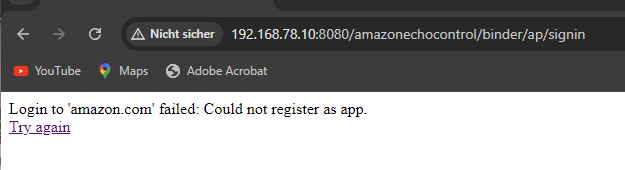

Since I had the issue since a few days now, I tried to ā€œlogout and re-registerā€ a few times. And it worked - until today! :wink:
The following ERROR shows up, after trying to login and re-register the App:
A few words:
  • I’m in germany and after ā€œlogouot and re-registerā€ my openHAB got connected to ā€œeu-api-alexa.amazon.comā€ (before that it was ā€œalexa.amazon.deā€ AFAIR).

Try
That’s a different error (Invalid redirect) and did not work with me (Login failed). I’m already signed out from the App and while trying to re-register Alexa, the login failed.
