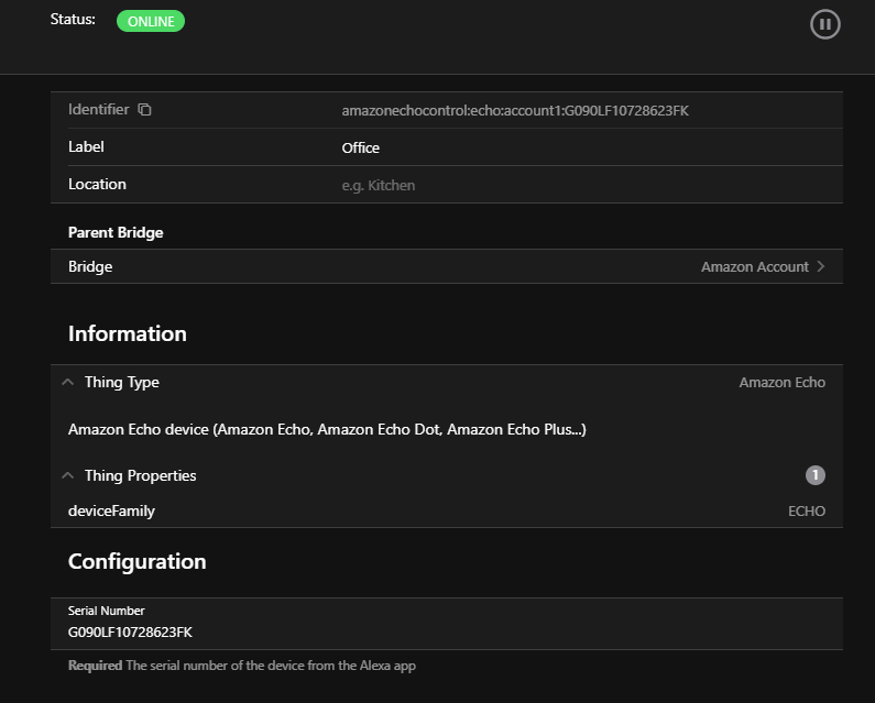

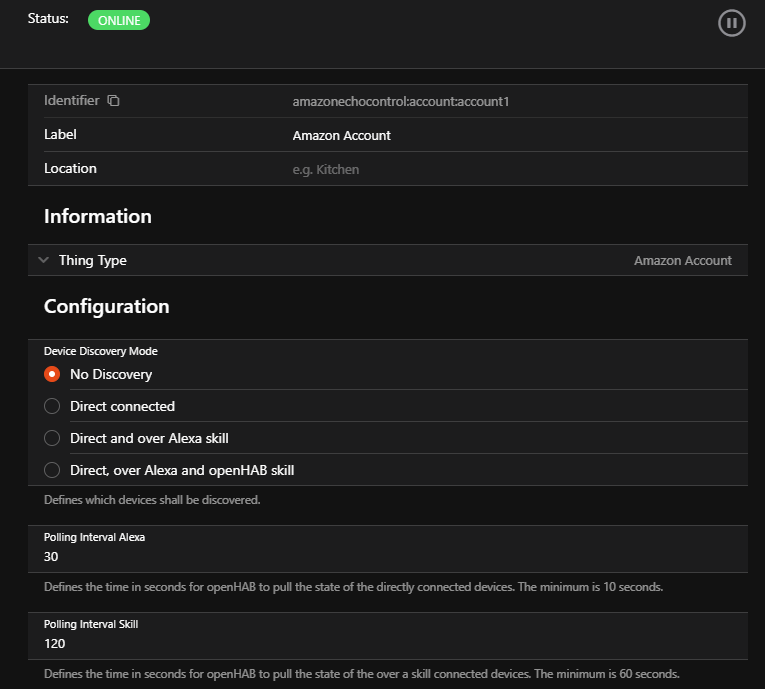

Amazon echo control lastVoiceCommand seems to have stopped updating about a week ago. I just got time today to start looking at. I ultimately decided to upgrade to openHab3. Below is my configuration:

256 x Active x  80 x 3.1.0                 x openHAB Add-ons :: Bundles :: Amazon Echo Control Binding

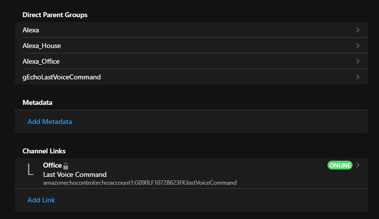

If I use the openhab-cli to issue the command openhab:send Echo_Office_LastVoiceCommand "test", the office echo says “test” and the following entry is made in the events.log:
2021-11-09 13:29:00.293 [INFO ] [openhab.event.ItemStateChangedEvent ] - Item 'Echo_Office_LastVoiceCommand' changed from null to test

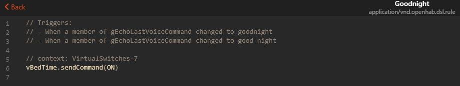

However, if I say something to the same echo, I never see an entry in my long for Echo_Office_LastVoiceCommand. I have a rule as follows:
However, when I say good night to any echo, the rule is not triggered. As of a week or so again, it was.

The websocket connection is broken in the openHAB version of the binding.
Correct, with the SmartHome/J-Version of the binding…it works…
Are there plans to get the openHAB-Version of the binding back to work ?
