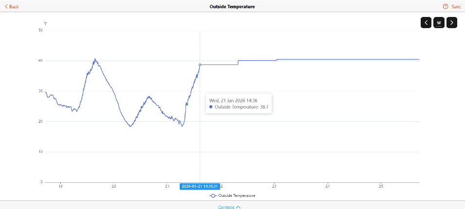

I’m also experiencing the same issue! My items stopped receiving updates from the Ambient Weather binding on 01/21 around 14:36 EST. It received two more updates (1 update on 01/22 and another one on 01/23) and then stopped completely. I have deleted and created a new bridge and and thing, recreated application and API keys on AmbientWeather.net with no luck. I have verified that my weather station is in fact sending data to ambientweather.net. The updates are just not coming through the binding.
Hopefully someone can look into it!
