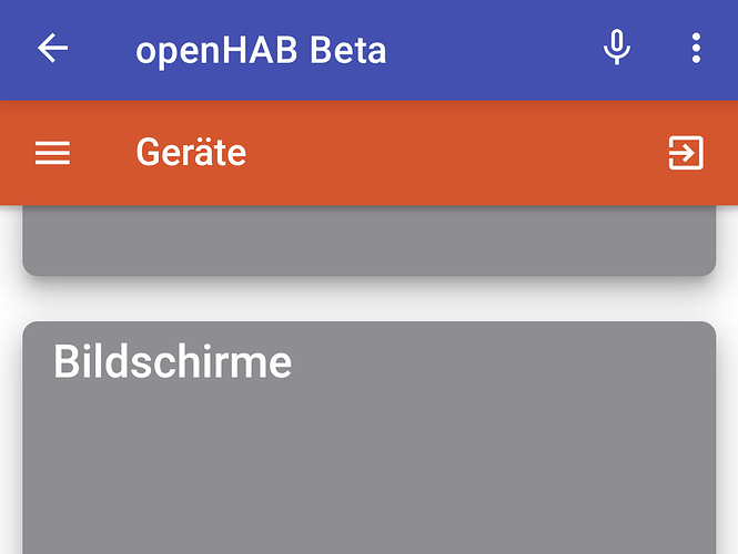

Is it possible to hide the upper status bar (blue in the screenshot) when showing the new UI? The new UI now also brings one with it (red in the screenshot).
Yes, that’s possible. There’s a PR implementing it: Implement JS interface of OH3 UI by mueller-ma · Pull Request #2328 · openhab/openhab-android · GitHub
