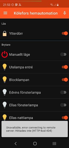

Also a tiny problem: My app works fine. However I get a popup with a HTTP 404 error message every time I start it. At the same time I get this in my Apache log (using Apache as a proxy):
[01/Dec/2020:18:40:46 +0100] "GET /api/v1/settings/notifications HTTP/1.1" 404 1194 "-" "openHAB client for Android
The new UI is already implemented in the latest beta version, but not yet polished.
Can you post a screenshot of the error? Which app version are you using?
It’s version 2.15.15-beta. Screenshot:
Screenshot_20201201-215334_openHAB Beta
edit: Btw, sorry for not looking close before asking. I found the item for OH3 gui in the app menu now. I guess I seldom look in that menu :stuck_out_tongue:
