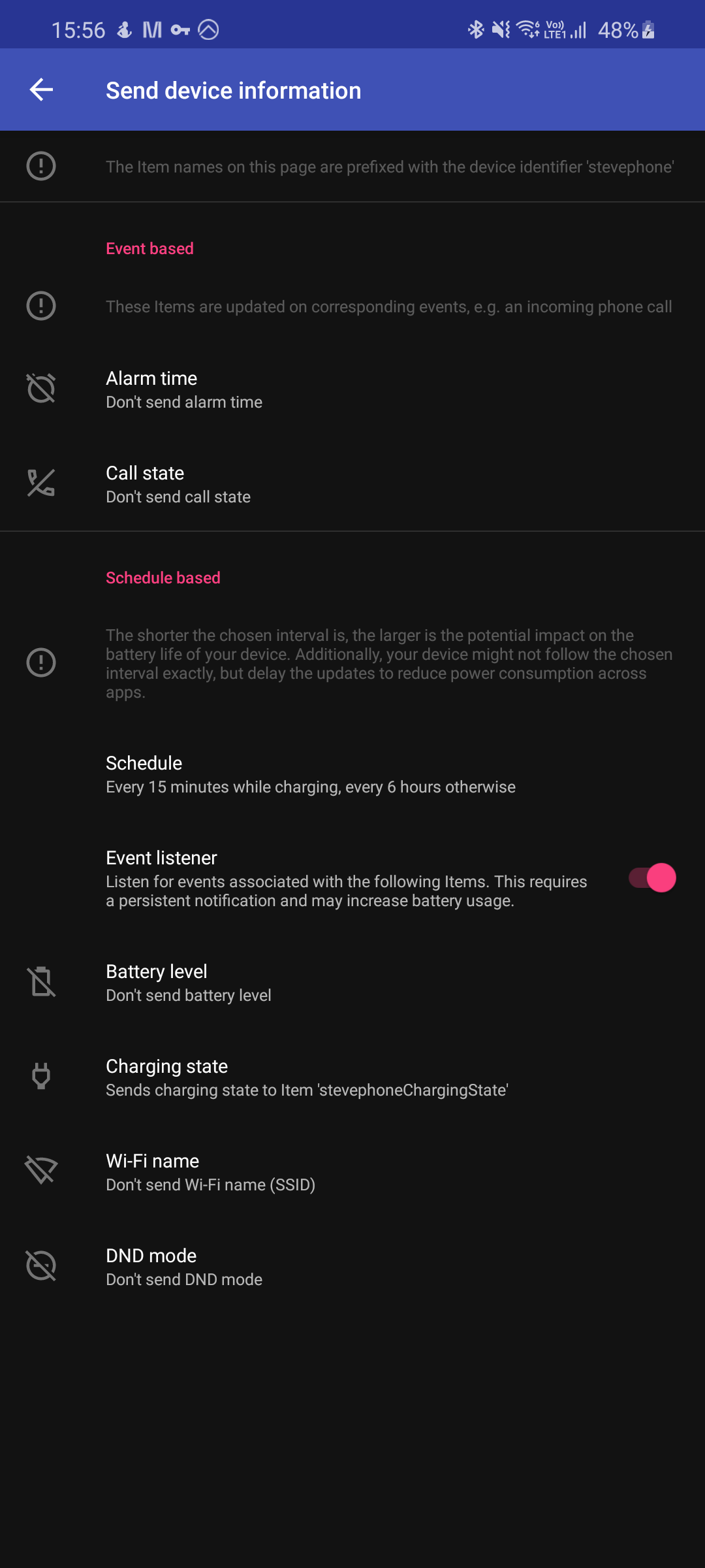

I just tried setting this up, I created an item:
Switch stevephoneChargingState "Steve Phone Charging State [%s]"
And configured the device identifier as “stevephone”, I turned the “Event listener” switch on and switched on the “Charging state” option and left the item name as “ChargingState”. The “Send device information to server” screen looks like this:
If I plug the phone in to charge the phone gets a notification that says:
1 item could not be updated
Item 'stevephoneChargingState' update failed: HTTP code 400
Any suggestions on how I could make it work?
Try using a String item. From the code, the charging state is sent as a string containing the connected charger: openhab-android/mobile/src/main/java/org/openhab/habdroid/background/BackgroundTasksManager.kt at main · openhab/openhab-android · GitHub
@mueller-ma I think also supporting switch items would make sense here, as ‘charging state’ seems most logically connected to a boolean charging/not charging instead of a string.
Changing the item to a string seems to have fixed it. I can now see the item value changing between UNDEF and AC when I disconnect and connect the charging cable. The contents of events.log looks like this:
