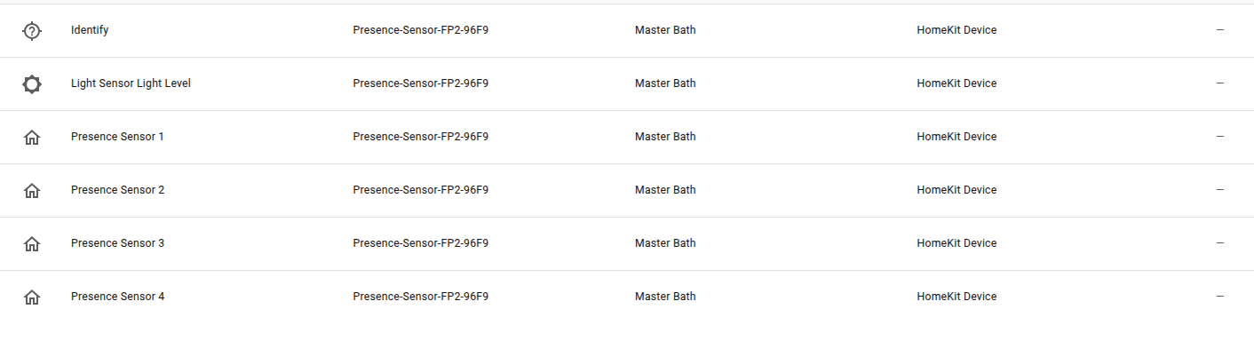

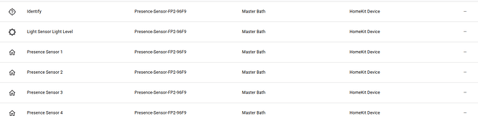

For what it’s worth I think the duplicate channels refers to the fact that you can configure different presense zones with the FP2’s and I just randomly set this one up with two zones for testing. From my experience with the HA homekit configs that means that 3 presences channels are produced, 1 general for the entire detection area of the device and then 1 for each zone within that area.
Here’s an example from HA of one of the devices with 3 zones (and therefore 4 presence channels):
@JustinG many thanks for testing. It revealed apparently two bugs – namely 1) the duplicated channels, and 2) that that error caused the valid pairing result not to have been persisted. I will get onto this.

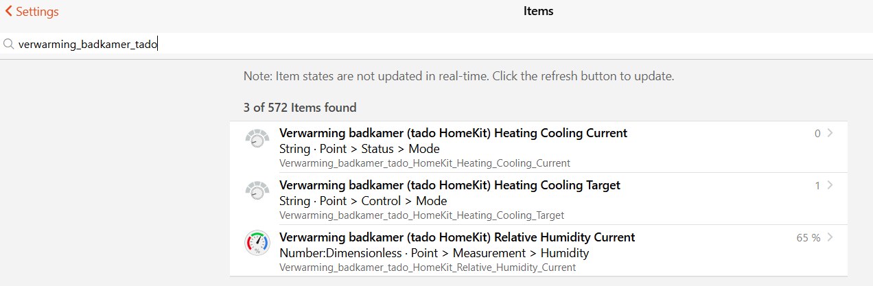

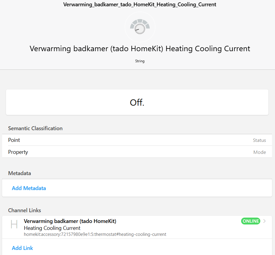

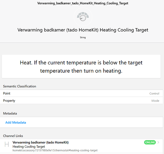

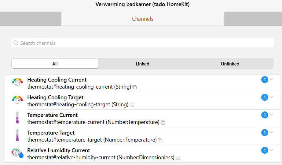

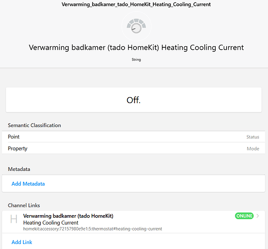

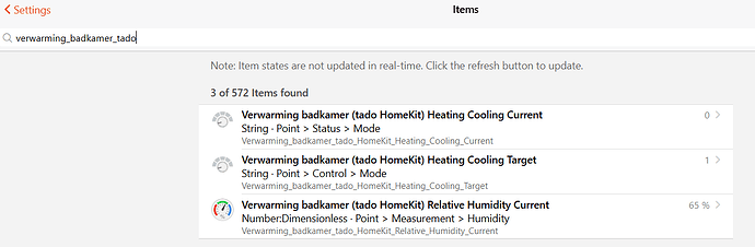

I then was able to create one of the things. I don’t understand all channels:
The 0 and 1 states seem odd, and when opening the items:
I understand the temperature-target, of course, but it’s not yet working:

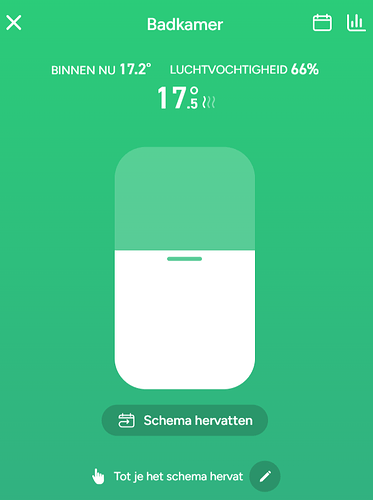

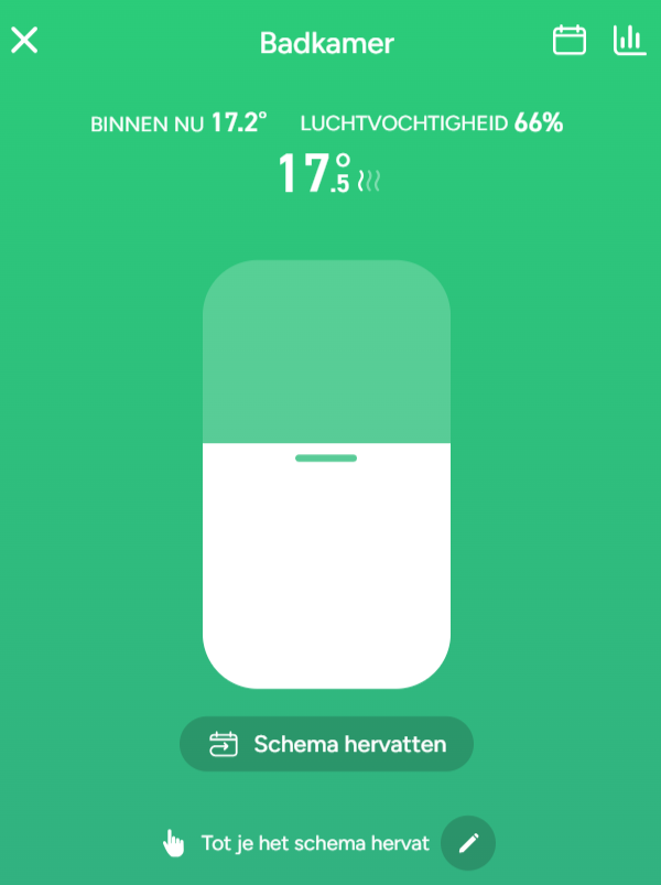

Furthermore: are these all the possible channels?
Because it’s of course important to know whether the device is on MANUAL or SCHEDULE… Or in any case, it’s important I can set it to either. (Having it later remain in a state that might not be accurate, is not up to standard, but at least it’s workable for me.)

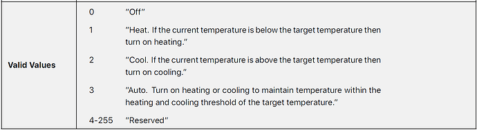

Congratulations!

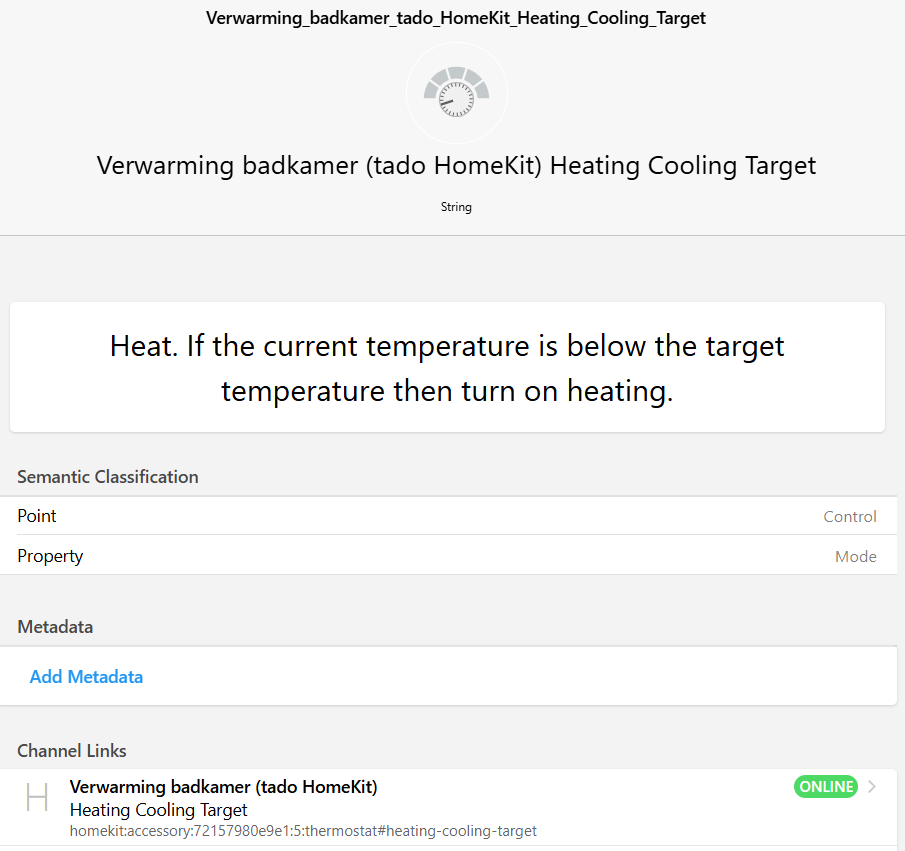

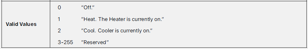

The Apple specification uses numbers to read the current state and read/write the target state. And as you say the meaning of these numbers is not always obvious. They are documented in the Apple specification (see screenshots below) so in the binding the channel’s state description contains a lookup between the number and its description.
What you see is certainly the full list of standard channels according to the Apple specification. If you follow the analog discussion on the Home Assistant forum you can see that everyone is complaining about this.
It may be that Tado has implemented some custom channels (which the binding currently cannot see) => So perhaps you can turn on trace logging, and capture the full response of the initial GET /accessories request which should let us see if there are such custom channels (albeit not telling us what they mean..)
Indeed. I think tado is being disengenuous when they claim that HomeKit is a one for one replacement of their own (paid) API..
According to your logs this channel is aid:5, iid:15 .. and we can see the command value 18 being sent, and the same value coming back on the next polling. So I think the HomeKit API is working properly. My hypothesis is that since you have set a manual override in the app, this overrides what may come from HomeKit. You should probably try setting the heat-cooling-target channel to heat or cool or auto before you send the temperature setpoint command.
Unfortunately I think this will need some experimentation to unravel the arcana of Tado’s implementation; where unfortunately I am no wiser than you..
Ok. I have just pushed a fix for the duplicate channels issue; the new Jar is in the same location as before..

Three new (far more minor) issues:
- Although all the different presence zones are found and created as channels, they do not get values independently. Both of the individual detection zones trigger when there is presence in either of them (the overall zone triggers too, but that should happen).
- Maybe this is a homekit thing because it’s also true of my other sensors connected HA → MatterBridge → OH, but the binary values for presence are opposite what I expect. My other sensors come in as Switch channels, but OFF is presence detected and ON is no presence (I reverse that with a map profile). With these Contact channels, CLOSED is presence and OPEN is no presence. For presence channels I would expect the 1 value to be presence and the 0 value no presence.
- The HA connection is push not polling, the response time with polling is not great for a presence sensor.
Illumination channel seems to work just fine.
One additional question: I do not have these sensors set with static IPs, but the IP does seem to be one of the primary connection datapoints. Is the Thing actually using the IP, because that will likely change over time.

Interesting. My devices connected to HA do not have this issue. Each of the detection zones gets a different iid.
HA diagnositcs
