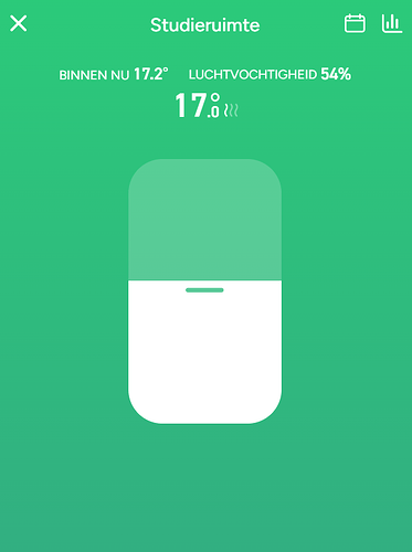

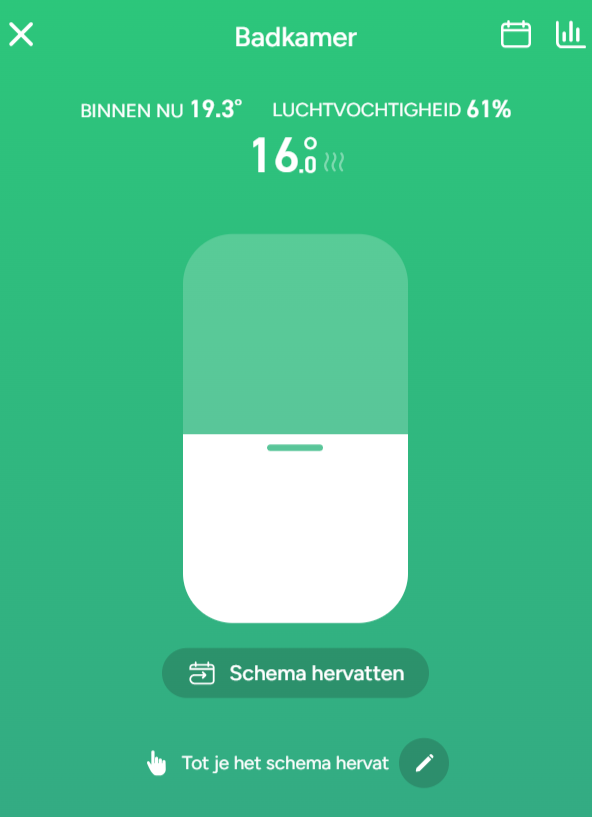

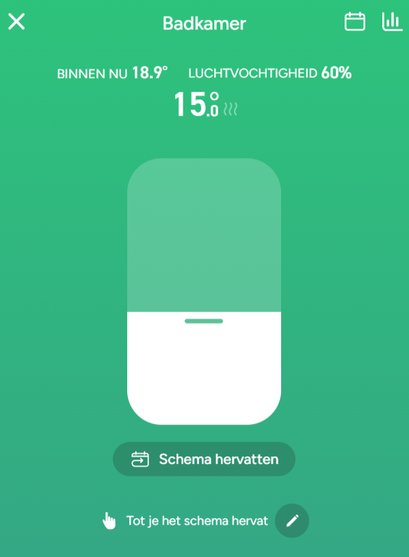

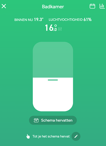

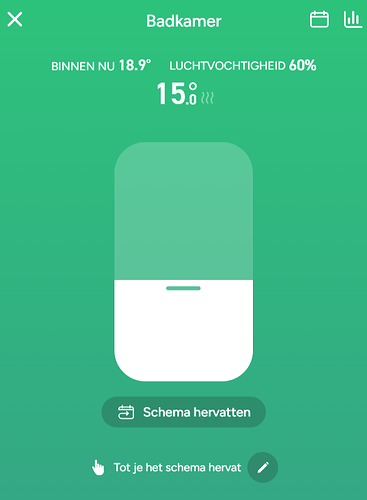

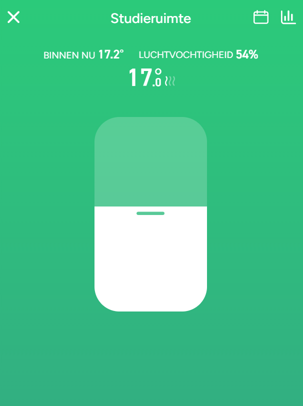

@AndrewFG, I haven’t had much time yet to play around with tado via HomeKit, but I just now installed the latest jar, and tried updating the target temp of one of my TVR’s.
This is what’s logged:
2025-11-23 09:31:15.846 [TRACE] [.handler.HomekitBaseAccessoryHandler - 2002      ] - homekit:accessory:72157980e9e1:3 throttling call for 1999 ms to respect minimum interval
2025-11-23 09:31:17.846 [TRACE] [mekit.internal.transport.IpTransport - 2002      ] - HTTP request:
PUT /characteristics HTTP/1.1
Host: tado\032Internet\032Bridge\032IB3857268224._hap._tcp.local.
Content-Length: 53
Content-Type: application/hap+json
{"characteristics":[{"iid":15,"value":16.0,"aid":3}]}
2025-11-23 09:31:17.889 [TRACE] [mekit.internal.transport.IpTransport - 2002      ] - HTTP response:
HTTP/1.1 204 No Content
Content-Length:0
2025-11-23 09:31:41.824 [TRACE] [mekit.internal.transport.IpTransport - 1491      ] - HTTP request:
GET /characteristics?id=3.15,3.14,3.12 HTTP/1.1
2025-11-23 09:31:41.857 [TRACE] [mekit.internal.transport.IpTransport - 1491      ] - HTTP response:
HTTP/1.1 200 OK
Content-Length:112
Content-Type:application/hap+json
{"characteristics":[{"aid":3,"iid":12,"value":0},{"aid":3,"iid":14,"value":17.3},{"aid":3,"iid":15,"value":16}]}
2025-11-23 09:32:41.859 [TRACE] [mekit.internal.transport.IpTransport - 1489      ] - HTTP request:
2025-11-23 09:32:41.900 [TRACE] [mekit.internal.transport.IpTransport - 1489      ] - HTTP response:
HTTP/1.1 200 OK
Content-Length:112
2025-11-23 09:33:41.903 [TRACE] [mekit.internal.transport.IpTransport - 2023      ] - HTTP request:
2025-11-23 09:33:41.948 [TRACE] [mekit.internal.transport.IpTransport - 2023      ] - HTTP response:
HTTP/1.1 200 OK
Content-Length:112
I see the PUT call received a 204 No Content response. I thought 2xx was positive, but No Content sounds negative…?
After that call, GET calls seem to indicate that the target temperature is indeed 16 °C, but the tado app still indicated 17 °C (on SCHEDULE mode).
Rotating the TVR manually shows that it too was still set at 17 °C. Rotating it to 15 °C doesn’t change the response to the GET calls:
2025-11-23 09:39:42.291 [TRACE] [mekit.internal.transport.IpTransport - 2155      ] - HTTP request:
2025-11-23 09:39:42.338 [TRACE] [mekit.internal.transport.IpTransport - 2155      ] - HTTP response:
HTTP/1.1 200 OK
Content-Length:112
{"characteristics":[{"aid":3,"iid":12,"value":0},{"aid":3,"iid":14,"value":17.2},{"aid":3,"iid":15,"value":16}]}
All HTTP 20x responses are positive. The 204 indicates that there was no content supplied. Which is self evidently true as you can see from the log. An HTTP PUT request does not elicit a content response; whereas an HTTP GET does..
Tado TRVs have a “Mode” channel that supports the values OFF, HEAT, COOL, DRY, FAN, AUTO. In HomeKit the corresponding channel (it is called Heating Cooling Target) apparently supports the values OFF, HEAT, COOL (only). Nevertheless it seems that if the TRV is set via the App to follow a schedule then it is in AUTO mode (??) and when in that mode it will not accept external temperature setpoint overrides. So probably you must first command Heating Cooling Target to HEAT. @Punsher says here that he made it work, so perhaps he can kindly provide more explanation?
Set the Mode to off and later Set the mode to heat. Then i was able to control the target temperature. However any such Action disables the schedule Set via the app. BTW how often are you receiving status updates on the humidity? I only got three changes in 24h. Seems a bit low.
Okay, I deleted my things, and then replaced the jar with the most recent one. I then did as you said:

Nothing happened in the tado app. https://app.tado.com/nl/main/home/zoneV2/3:
Interestingly, HomeKit registers a different humidity than the tado app, and ever stranger, it detects “current temperature” changes, which are also very different from what the tado app reads.

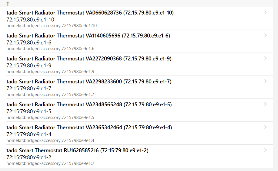

And now I see it! These are my zones:
  1. Zone 2 (Eetkamer) - 1 TVR + the thermostat
  2. Zone 3 (Studieruimte) - 2 TVR’s
  3. Zone 5 (Badkamer) - 1 TVR
  4. Zone 6 (Keuken) - 1 TVR
  5. Zone 8 (Gang gelijkvloers) - 1 TVR
  6. Zone 9 (Dressing) - 1 TVR
But these are the “to be things” still in my inbox:
I assumed “zone 3” would be 72157980e9e1:3. But instead, I need to look for the VA0000000000 number. So HomeKit controls the separate TVR’s, not the zones. And the thing I made is for VA0158226688, which indeed has been set:
openhab>
log:display | grep -i verwarming_badkamer_via
21:39:44.778 [INFO ] [openhab.event.ItemStateChangedEvent  ] - Item 'Verwarming_badkamer_via_HomeKit_Heating_Cooling_Target' changed from NULL to 1
21:39:59.491 [INFO ] [openhab.event.ItemStateChangedEvent  ] - Item 'Verwarming_badkamer_via_HomeKit_targetTemp' changed from NULL to 16 °C
21:40:08.823 [INFO ] [openhab.event.ItemStateChangedEvent  ] - Item 'Verwarming_badkamer_via_HomeKit_Relative_Humidity_Current' changed from NULL to 60 %
21:40:16.965 [INFO ] [openhab.event.ItemStateChangedEvent  ] - Item 'Verwarming_badkamer_via_HomeKit_Heating_Cooling_Current' changed from NULL to 0
21:40:30.516 [INFO ] [openhab.event.ItemStateChangedEvent  ] - Item 'Verwarming_badkamer_via_HomeKit_ambientTemp' changed from NULL to 19 °C
21:41:54.098 [INFO ] [openhab.event.ItemCommandEvent       ] - Item 'Verwarming_badkamer_via_HomeKit_targetTemp' received command 15
21:41:54.101 [INFO ] [openhab.event.ItemStatePredictedEvent] - Item 'Verwarming_badkamer_via_HomeKit_targetTemp' predicted to become 15
21:41:54.103 [INFO ] [openhab.event.ItemStateChangedEvent  ] - Item 'Verwarming_badkamer_via_HomeKit_targetTemp' changed from 16 °C to 15 °C
Also reactivating the schedule in the tado app has effect in openHAB.
This looks workable, hooray!

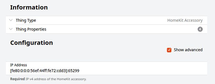

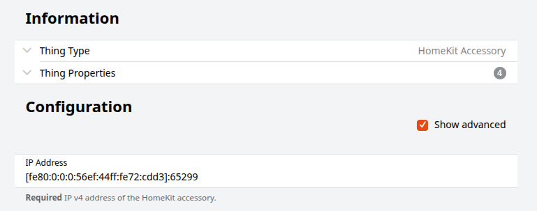

I didn’t report this the first time as I figured it was user error, but having seen the exact same pattern a second time, I wanted to report some observations that may or may not be relevant:
  1. When I first added the device as a Thing and got the “failed to connect” error, I checked the thing advanced properties and noted that where it says ip4 it had instead collected the ip6 version of the ip. I have iv6 enabled because I also use matter, but the other two FP2’s that I now have connected and working show a correct ip4 address in that field. Manually setting that value to the correct ip4 did not fix any issues.
  1. The MAC address is incorrect. The ip6 address correctly shows the MAC address of the device, but the MAC address field shows some other MAC altogether which does not match anything on my network as far as I can tell. Interestingly, it turns out my two working FP2 Things also have completely random MAC addresses but since they work that doesn’t seem to be the issue.
Eventually, it seems I hit the correct sequence and timing of restarts and pairing attempts combined with the correct incantations and planetary positions and I get the device full connected and eventing and from then everything remains rock solid.
I don’t know if there’s a particular point in the process where logs would be helpful (I’m not even sure I can recreate the ip6 issue, I’ve only noticed it one time). But, I’ll report back if I figure out what it is I’m doing wrong.
Two things come to mind:
  1. Homekit does not (cannot) use IPv6 addresses. So any connection attempt using ipv6 will certainly fail to connect and pair. => Can you please confirm that the mDNS discovery is actually putting a thing in the inbox with an ipv6 rather than an ipv4 address? Ideally show a trace log during the respective discovery process.
  2. Apropos your comment about the mac address. Indeed Homekit uses a unique id that looks very much like a mac address, but may actually not be. We made a change to the readme to reflect that. In many cases the unique id is identical to the mac address, but apparently in your case it is not. Important is that you use the unique id that is found by the mDNS discovery (and not the mac address if they differ).
EDIT: I have just committed a new version of the v5.1.x SNAPSHOT Jar that addresses both the ipV6 issue and the (not) mac address issue. (NB unfortunately due to a recent commit in OH core, the v5.0.x SNAPSHOT Jar no longer tracks the latest commits).
I can confirm that I see no ipV6 issues now. I’ve deleted and re-created all three of my FP2 things and the first two have come back up and are working flawlessly.
Edit: Third device appears to also be working after a complete device rest. Something just got out-of-whack, it seems.

2025-12-07 10:43:27.627 [DEBUG] [rnal.handler.HomekitAccessoryHandler] - homekit:accessory:a9e2bbc924eb updated with 4 channels (of which 2 polled, 2 evented), 10 properties, label: 'null', equipment tag: 'null'
2025-12-07 10:43:27.627 [TRACE] [.handler.HomekitBaseAccessoryHandler] - homekit:accessory:a9e2bbc924eb throttling call for PT1.988423975S to respect minimum interval
2025-12-07 10:43:29.616 [TRACE] [mekit.internal.transport.IpTransport] - HTTP request:
Host: Presence-Sensor-FP2-CDD3._hap._tcp.local.:53762
Content-Length: 83
{"characteristics":[{"iid":2694,"ev":true,"aid":1},{"iid":2698,"ev":true,"aid":1}]}
2025-12-07 10:43:29.870 [TRACE] [mekit.internal.transport.IpTransport] - HTTP response:
2025-12-07 10:43:29.871 [DEBUG] [.handler.HomekitBaseAccessoryHandler] - homekit:accessory:a9e2bbc924eb eventing enabled for 2 channels
Links still existed from the previous thing so items were immediately linked back up to the channels. I’m guessing that’s why even on first pairing, the logs indicate that those two channels were set up for eventing.
However, despite that log statement, eventing does not appear to work for those two channels. Polling does work, however, and continues for about 10 minutes, until there is a connection error.
Successful polling:

Next polling attempt 1 minute later:
==> /log/openhab.log <==
2025-12-07 10:53:31.873 [TRACE] [mekit.internal.transport.IpTransport] - HTTP request:
GET /characteristics?id=1.2694,1.2698 HTTP/1.1
2025-12-07 10:53:46.874 [DEBUG] [.handler.HomekitBaseAccessoryHandler] - homekit:accessory:a9e2bbc924eb communication error 'null' polling accessories, reconnecting..
java.util.concurrent.TimeoutException: null
	at java.util.concurrent.CompletableFuture.timedGet(CompletableFuture.java:1960) ~[?:?]

A short time later, same connection issue (communication error 'null' polling accessories) occurs.
I suspect this is the underlying issue I was having before, but with the ip repeatedly changing back to the ipv6 form on the attempts to reconnect, it was less obvious what was going on.
I cannot think of what is different about this device that is causing the problem:
  1. It is on the same firmware as the two that work flawlessly. So it shouldn’t be about the information the device is sending.
  2. It ran for many months when connected to HA without ever having a connection issue. So, unless I’ve borked the device somehow with my repeated attempts to get it working the device itself is not faulty.
  3. The device retains it connection my lan and the aqara app. So, this has to be just an issue with the homekit connection.
I thought it could it possibly be the fact that the items and link already exist when this thing is removed, readded and re-paried, but that was also true for the other two devices that I had to create new things for with the newest jar, and this issue is definitely not occurring with the other two.
I’ve been trying to do this with out resetting the device itself, but I’ll do that next and see if that helps.
A thorough analysis of my logs from the last few days of adding FP2s has revealed the ultimate culprit.
When pairing a device, the pairing action returns an OK status (and the binding considers the device paired) when initial pairing is complete, but the logs show a secondary pairing “verification” step. This can get interrupted (that issue I think is related to my own OH’s network issues which I still haven’t managed to track down). If that verification is interrupted, then you get the unstable connections I was seeing in the FP2s where calls can produce “null polling” and result in the socket connection being dropped.
I don’t think this is going to be a common issue because you have to be unlucky enough to get some LAN interruption during the pairing process otherwise the verification step completes quite rapidly, but there is at least this possibility for the binding and the device to disagree on the status of the pairing connection.

The polling issue is not a big deal it just means that I have a rule which runs on updates to one of my sensors which is now borked and has to be redone because the device updates every minute instead of only on changes. Of course, it didn’t do this before because the polling was managed outside of OH by HA and only changes were sent through the bridges to OH.
If the pair-setup did complete then OH will have persisted the key. You can check it in a homekit key json file (offhand I cant remember its exact name) but it is in the userdata json folder. And this key is used every time that the thing subsequently tries to go online (via pair-verify). And if that pair-verify request fails (the first or any other time) then the binding will retry at intervals of 4 seconds, 16 seconds, 256 seconds, and finally 300 seconds (5 minutes) thereafter. So maybe all you need to do is wait a bit more patiently..
Yeah, it’s more insidious than that, which is why I suspect it has more to do with the FP2s than the binding. That the key is persisted is clear because a rebooting the device and the thing recreates the connection, it’s just that something is still missing between the two (again, at this point, I’m fairly certain its on the device side) because that connection is unstable and will fail within a few minutes when for some reason a poll request is sent but gets some null response.
I can guarantee this is not the solution to this particular problem. I think one of the logs posted in the “you can ignore this” section above, is one of the examples where in the middle of the that initial verification process all of those subsequent retrys fail to connect. Then I reboot the device and the Thing and verification runs to completion (if I’m reading the logs right) and that’s when the channels are then created. As I said, the device gives the appearance of working for at least a few minutes after this, but then runs into the problem.
Only pairing attempts where that initial verification attempt runs to completion result in a permanently stable connection to the device. :person_shrugging:
Don’t waste any more of your time trying to work this out, you’ve almost certainly got more important things to attend to, and if I ever need to connect more FP2s, I now know what success and fails look like so the process will be greatly streamlined for me.
Hi, i recently paired two fp2 sensors. It took few restarts both devices and OH but worked. I was previously using smarthings and matter binding to push the values to OH. But using this binding is more reliable and simple.
