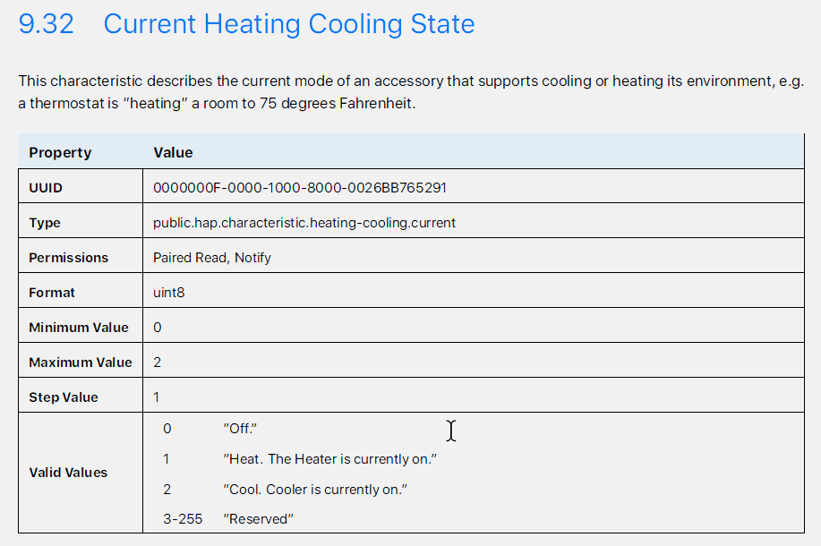

The Apple specification says the following.
And your JSON confirms that it should comply with the Apple specification – namely that the value is a uint8, it is an evented channel, it has possible values of 0, 1, or 2, and its current value is 0.
							"iid": 12,
							"type": "F",
							"perms": [
								"pr",
								"ev"
							"value": 0,
							"maxValue": 2,
							"minValue": 0,
							"minStep": 1,
							"format": "uint8"
value is only very seldom 1
I guess that essentialy confirms the above. Or?

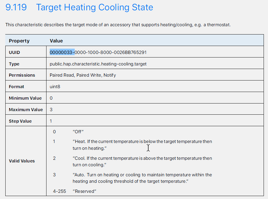

EDIT: for completeness here is the specification for Heating_Cooling_Target
