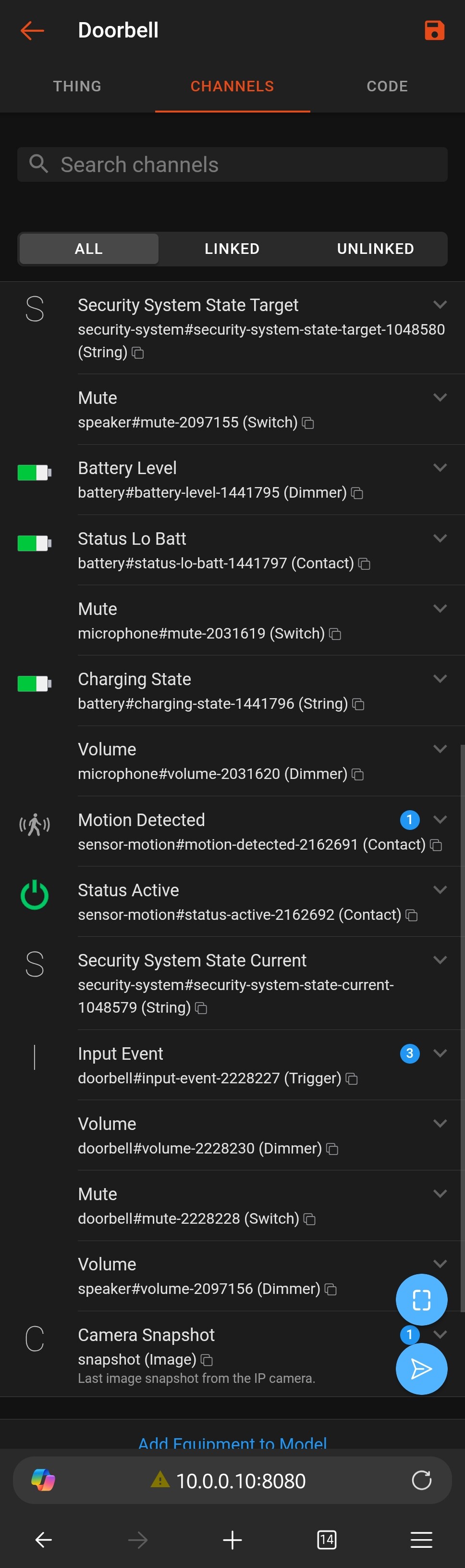

Hi @AndrewFG , This is what i can see in channels.
Are you referring to Active Starus?
Let me check the link for refresh behavior.
@tizen I think some time ago you provided some json logs for a door camera. Was that json for the same thing as shown in your screenshot? (It helps to confirm we are talking about the same animal). If not, can you please disable the thing, turn on log trace, and re-enable the thing, and send me the part after GET /accessories and showing the description of things being created.
Yes all logs i shared are of doorbell camera. It has mmwave sensor. And screenshot is of same. I can send you logs again after some time.
