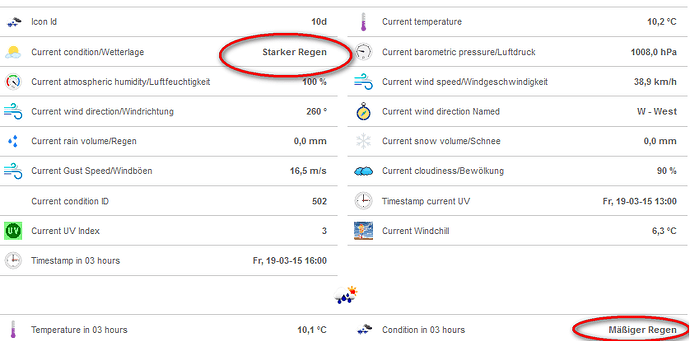

The binding is Multilingual.
Did anybody had a found a list of all weather conditions in german?
I would like to use it for the icons.
You don’t need a map/list. Translation should be done by the binding, like here:
Hi Stefan,
I am not sure why you need them. As @fibu-freak already mentioned the API and the binding are capable of returning translated / localized weather conditions. I once started to collect the German translations because OWM seemed to have an issue with their spelling (e.g. everything was written in lower case letters) but it looks like they fixed it recently.
Yes, they fixed the lower case letters a few days.
I would use the condition value in rules. That’s the reason why I ask for it.
You should go for the condition-id. It is a fixed numerical value and independent from translation. Have a look here for a detailed description and a complete list of all weather condition codes.
