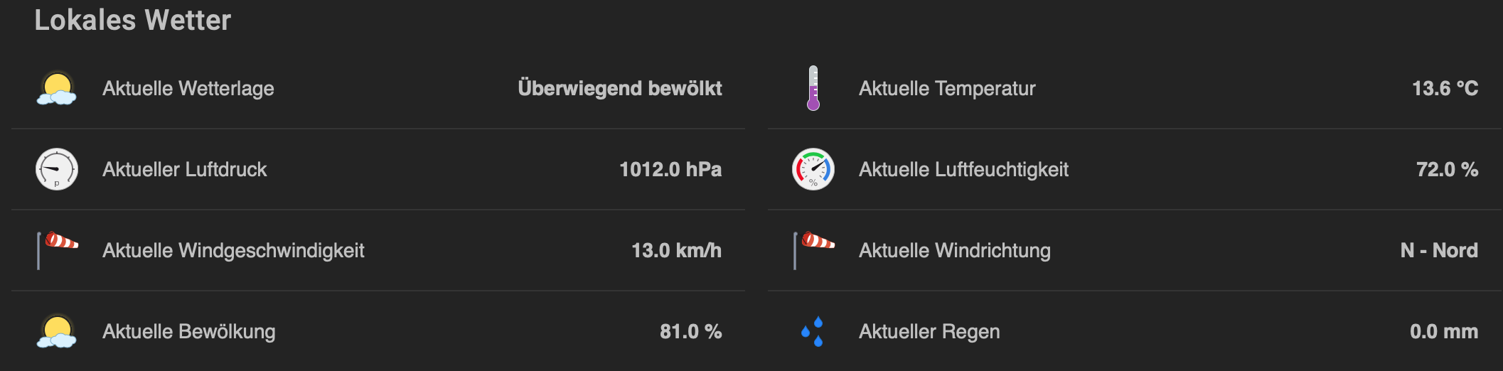

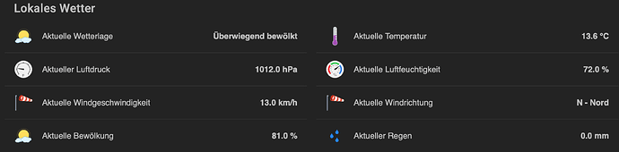

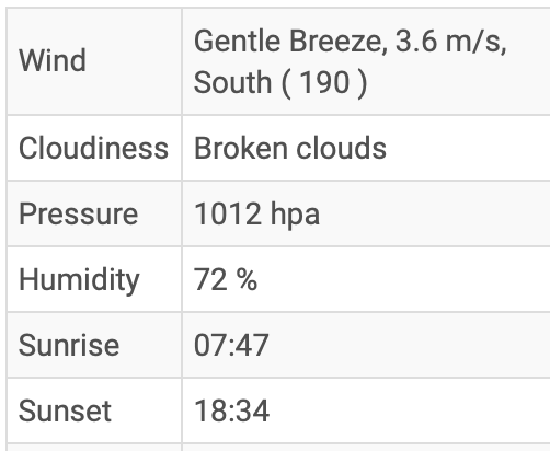

These are the values based on my geo location in OpenWeatherMap. Once checking my basic ui, I find the following:
What I am wondering now, why is the wind in the upper picture 190 - South, the provided value is based on the mapping Nord, which is related to a value of 3.3161255…do I have a bug in my mind? My understanding was, I have the mapping table and based on the provided value of 190 the wind direction should be South.
Furthermore yesterday was rain, the OpenWeatherMap page showed rain 1.2mm but my system didn’t. I don’t get it :-D.
Hope someone can help me out.
Thx you.
Nobody an idea? @cweitkamp maybe?
Found the issue…I had a wrong item definition for the wind direction. instead of number:Angle I used number:dimensionless…problem solved, user happy :smiley:

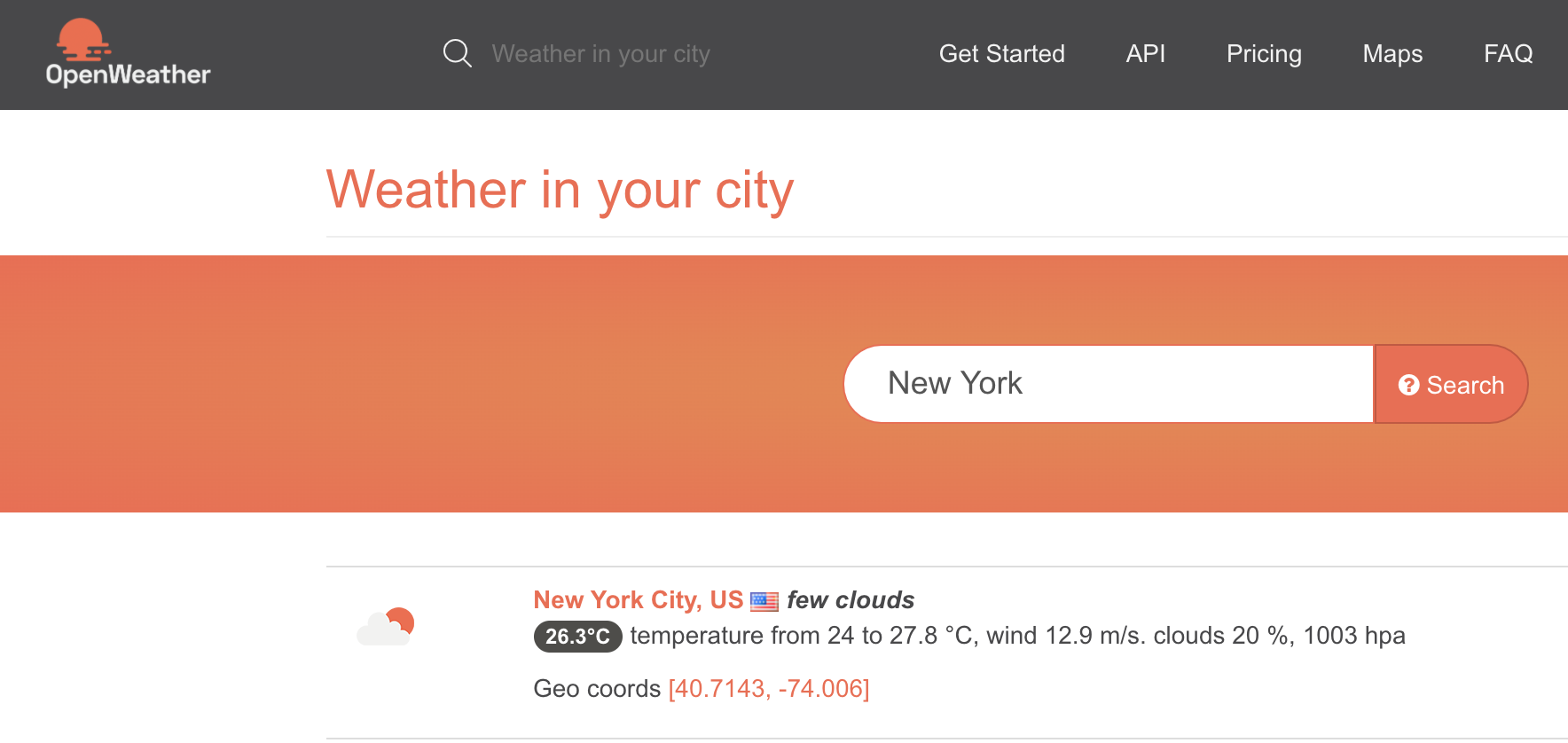

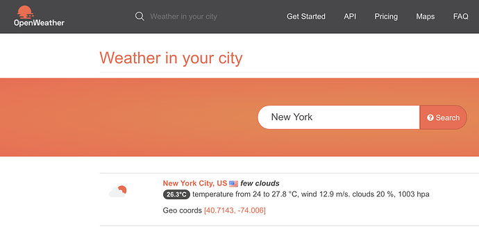

I found the problem!!!
You have to use the geo coordinates given by Openweather Website (e.g. New York): Find - OpenWeatherMap
The geo coordinates are: [40.7143, -74.006]
I used before the geo coordinates from Google: 40.6976684,-74.260556
When putting the geo coordinates from Openweather into the thing definition it works!!!
NEW => WORKS:
Thing weather-and-forecast New York "Wetter und Vorhersage in New York" [location="40.7143, -74.006", forecastHours=96, forecastDays=0]
BEFORE => WORKS NOT:
Thing weather-and-forecast New York "Wetter und Vorhersage in New York" [location="40.6976684,-74.260556", forecastHours=96, forecastDays=0]
