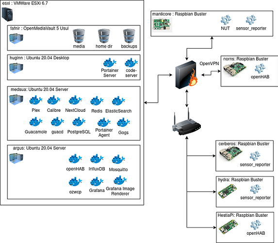

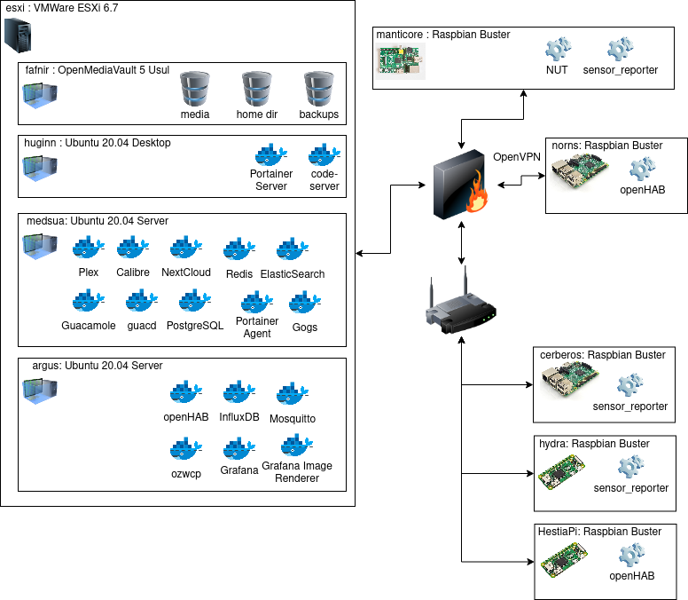

Overall Environment
My overall IT environment is much larger than just home automation. Those parts are out of scope for this post for the most part, though I might bring some roles in for discussion and example.
My overall hardware environment consists of a server class machine running VMWare ESXi and a number of Raspberry Pis of various models (1s, 0Ws, and 3s) connected to the same network either via ethernet, WiFi, or VPN.
On the ESXi machine I have four VMs:
Machine Name Purpose
huginn Virtual Desktop running Ubuntu 20.04 Desktop (if anyone has a recommendation for a good distro that performs well as a VM I’m open to suggestions)
fafnir NAS running OpenMediaVault sharing file systems using NFS and SAMBA in some cases
medusa Media server hosting stuff like NextCloud (and related services), Plex, and Guacamole
argus The home automation server
fenrir I’ve turned this one off but it used to run Nightscout and related services
The RPis include
Machine Name Type Purpose
manticore RPi 1B NUT server, sensor_reporter that pushes Govee BT Temp/Humi sensor readings to MQTT and various other odd jobs.
hydra RPi 0w Connected to door and window sensors that were left behind when the alarm system was ripped out before we bought the house, runs sensor_reporter to report the changes as MQTT
cerberos RPi 3 Connected to reed sensors and relays to control the garage door, has a Raspicam attached to verify the doors are open or not and monitor the garage. Uses sensor_reporter to publish and subscribe for commands to control and report the status of the doors.
norns RPi 3 Located over 100 miles away at my dad’s house, runs openHAB with a small Zwave network of devices; this openHAB is configured with Marketplace MQTT Event Bus to report the status of the sensors to the openHAB on argus.
hestiapi RPi 0w HestiaPi thermostat, this machine is not managed by Ansible (yet?), also running openHAB but limited to just the thermostat.
For a small business this isn’t so much but for a single person to establish and maintain in their spare time it would be pretty hard to manage manually. Enter Ansible.

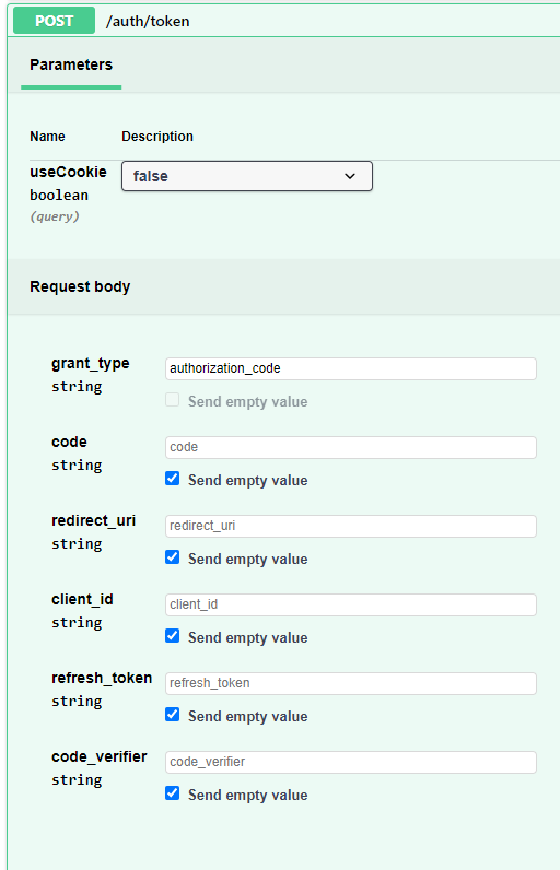

You have 2 choices for that. I think the best is to generate and use an api token. If you enable it basic authentication is also available. I use an api token with HABapp.
Yes. What bindings get installed is configuration (see /var/lib/openhab/config/org/openhab/addons.conf I think). All configuration gets saved to the git repo. So when I restore the config from git, it also installs the bindings. Actually creating openHAB configuration from Ansible feels a lot like writing a program to write a program. An interesting exercise but ultimately a waste of time. But that’s just my opinion.
There is a chicken and egg problem. You can’t generate the token until you have an admin login. You don’t have an admin login until after the first time you go to MainUI after installation.
