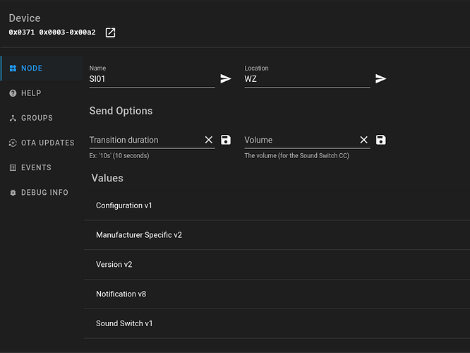

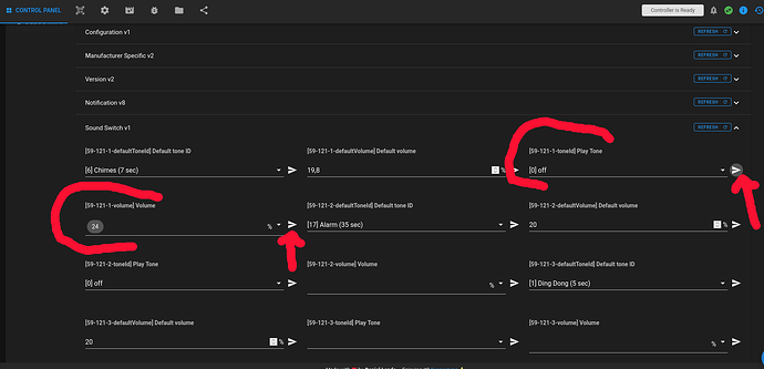

I think we have to focus on Zwave js ui settings.
  1. is there any device you can control directly within the ZUI web page. Like switching a light or socket outlet on /off.
  2. if that works, can you control the siren
  3. set volume to 25 and press the arrow next to the value on the right sight.Does the program confirm the parameter. if not check the ZUI settings
How did you ‘include’ the siren, with safety code or not. The siren is really a diva. Once there was an update from ZUI and I had to ‘exclude’ and ‘include’ it again, because it showed a proper connection but I could not set any volume or tune parameter.
Maybe you can tell us your components - which zwave stick - OH version and ZUI version. Where and how did you install ZUI program.
