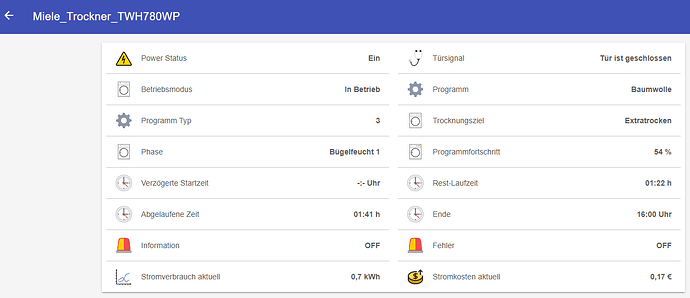

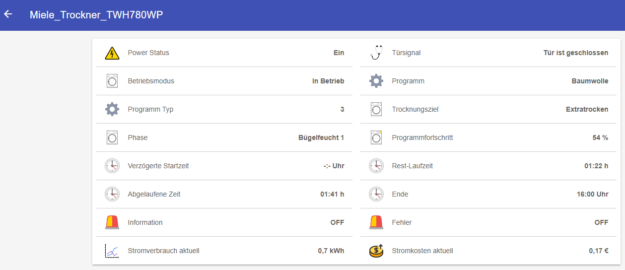

Here i see the power consumption. The task is now to extract the value using some transformation code. Will see if i get this done?
In that case the best solution would be to have the Miele Cloud binding support this. I don’t know if @BjoernLange would be interested in adding channels for water/energy consumption? :slight_smile:
Retrieved the power consumption value of the tumble dryer by application of the following JSONPath transformation :
$.state.ecoFeedback.currentEnergyConsumption.value
Coverted the retrieved string to a number in order to calculate power consumption cost.
@BjoernLange
Nevertheless, i would also very much appreciate if you could support the “ecoFeedback” data within the Miele cloud binding. Actually i anyway need both Miele bindings, “Miele@home” and “Miele cloud”, to use all interesting parameters. Both bindings have their advantages versus the other one.
