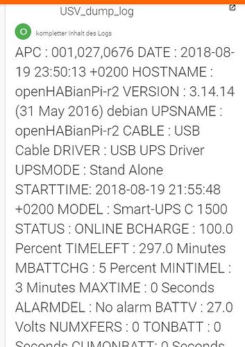

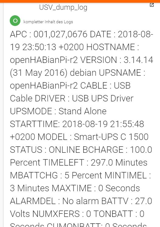

Hi Roi, i used the instructions on github and finally got it work - thank you.
Can you help me understand why i get this messy representation of data on paperUI?
