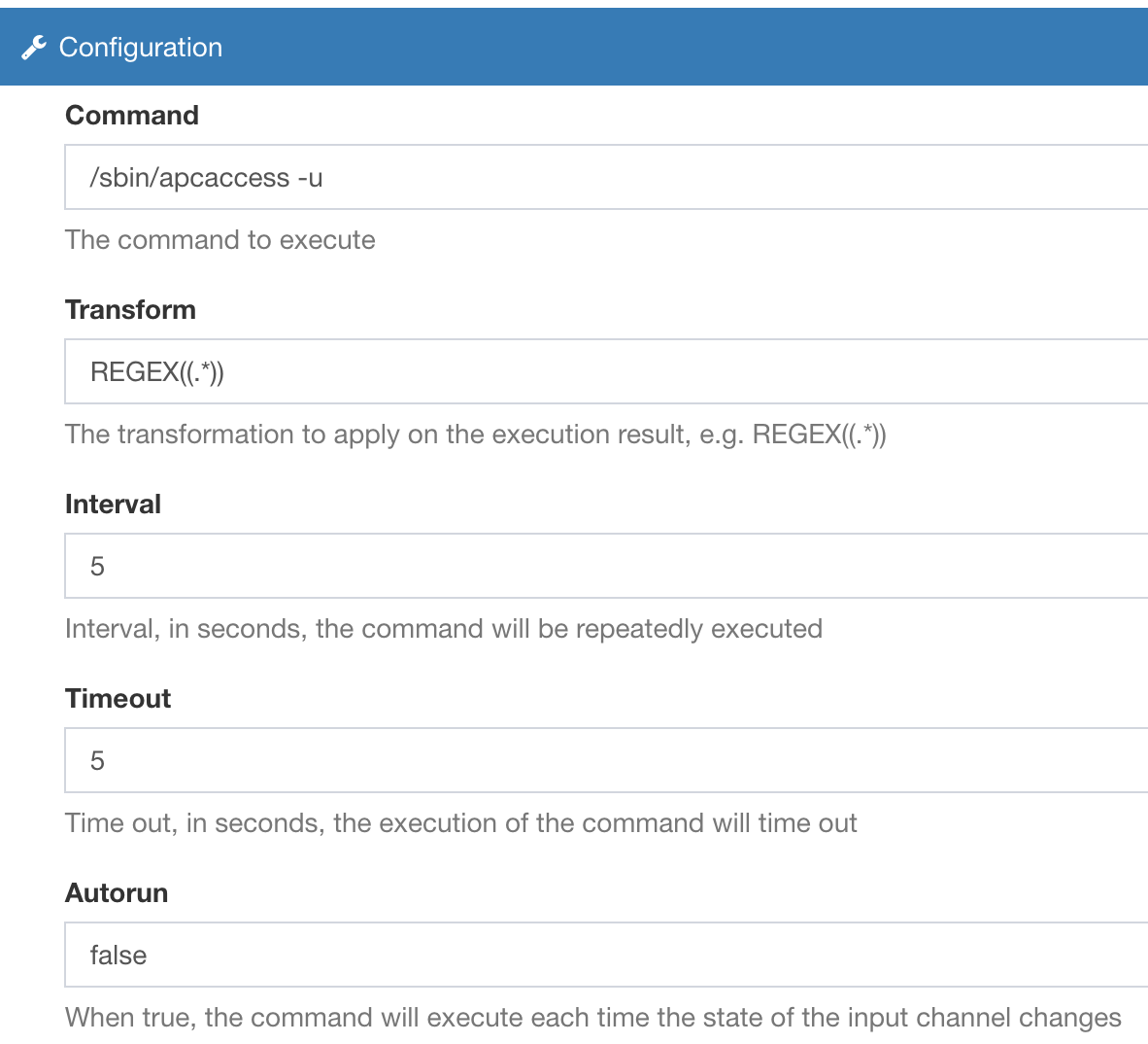

I created a Thing using HABmin that looks like the following:
It runs the /sbin/apcaccess command every 5 seconds (if there is a power outage, I’d like to know about it fairly soon).

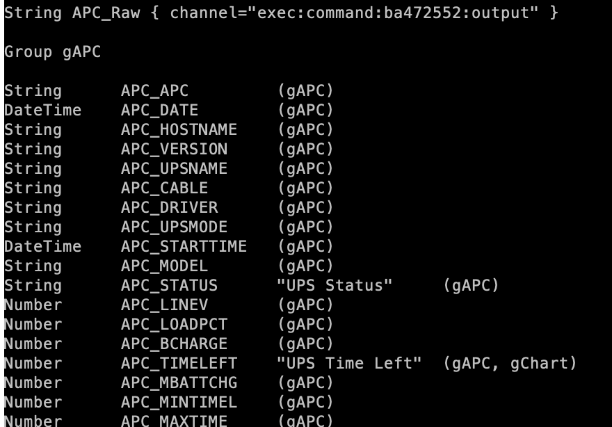

Then, I have a set of items defined to capture the results from the apcaccess command:

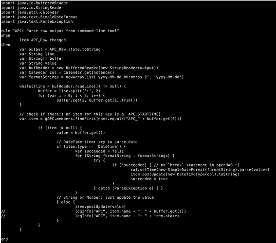

The following rule is used to parse the fields returned by the apcaccess command into the items that I’ve defined:

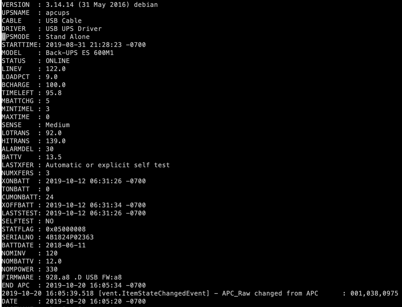

But I get the following every 5 seconds in the events.log, which obviously results in a lot of wasted disk space. It also makes it more difficult to find the really interesting information in the events.log file.

Just comment out the LogInfo line
	import java.io.StringReader
    import java.utils.Properties
	rule "APC UPS String spliting"
		Item APCUPSQuery_Output received update // Change this Item to your "apcaccess -u" exec query output
//	 or Item testtrigger changed	// Only a test switch to force the rule to run for testing
	//	logInfo("APC Info", "APC UPS Query update = \n"+APCUPSQuery_Output.state)	// Change this Item to your "apcaccess -u" exec query output // Comment out this line to stop it populating your openhab.log file
        val results = new Properties().load(new StringReader(APCUPSQuery_Output.state.toString))
    //	logInfo("APC Info","APC UPS information.\nUPS Named "+results.get("MODEL")+" is "+results.get("STATUS")+", with an internal temperature of "+results.get("ITEMP")+"°C.\nLoad = "+results.get("LOADPCT")+" Percent, Current Line Voltage is "+results.get("LINEV")+"\nBattery is at "+results.get("BCHARGE")+" percent, giving "+results.get("TIMELEFT")+" minutes at current load, at "+results.get("OUTPUTV")+" Vac.\nCurrent battery voltage "+results.get("BATTV")+" Vdc")
