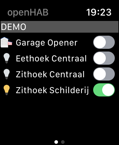

Had the same problem (incl. some other problems listed here). Here’s what worked for me:
In the iOS App…
  1. change “Local URL” from x.x.x.x:8080 to x.x.x.x to 8443
  2. activate “Always send credentials”
  3. activate “ignore SSL Certificates”
In the xxx.sitemap…
  1. Set the name to “watch”:
    sitemap watch label="MyFlat" {

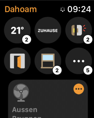

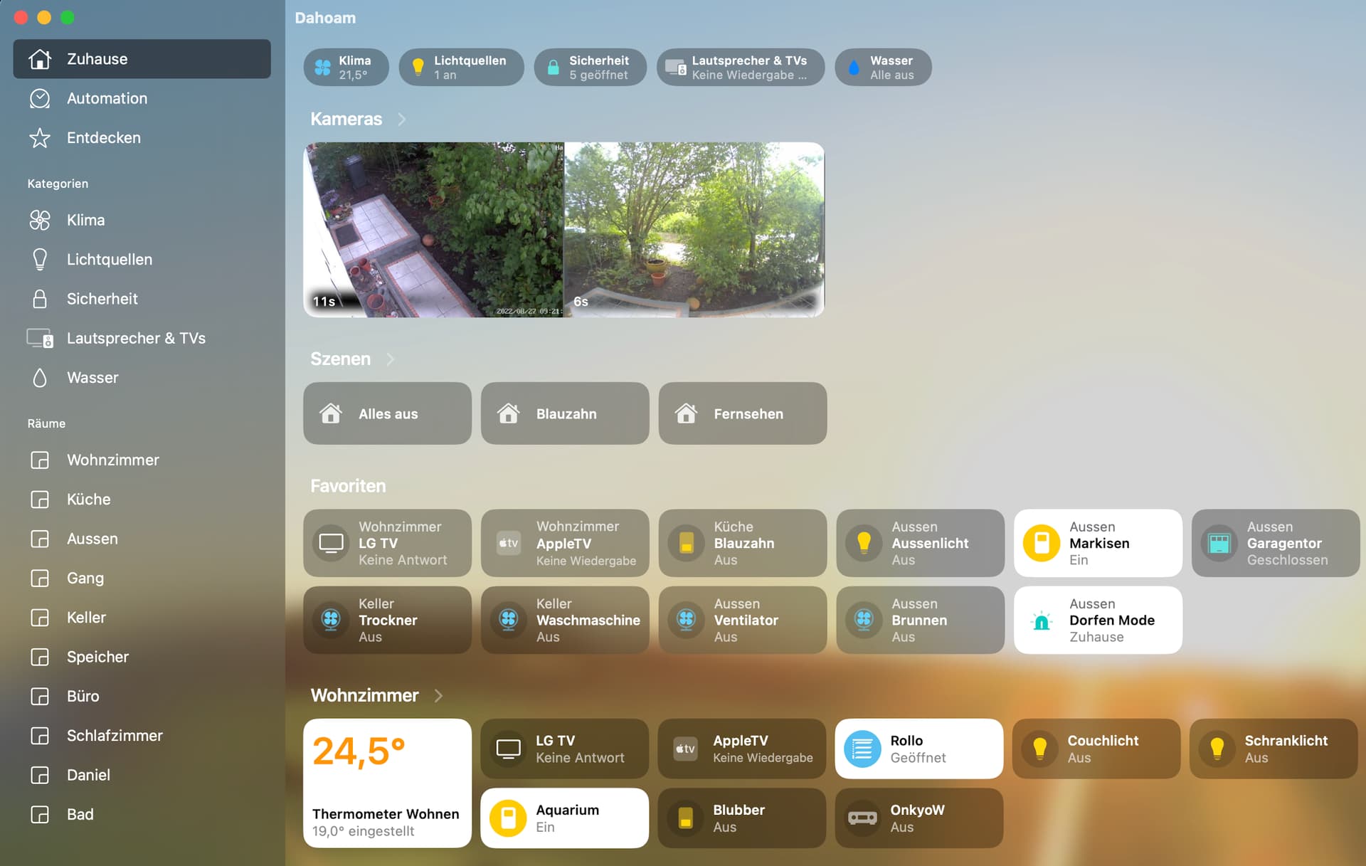

I also was looking around for a possibility to control some parts of my OH-environment with my apple-watch (and of course the iPhone) some time ago.
My solution (which may not fit to others): I forwarded a number of items to HOMEKIT via the HomeKit-integration-service. This integrates OH pretty well into the whole apple-environment, even Siri can be used. Usually you even do not need too many of the items on the mobile-device, so this should not be to much to do (and you even have to do nearly the same job with the additional sitemap if you run OH3). I use a old wall-mounted iPad5 as my Homekit-controller, this gives me additionally the possibility to control stuff from anywhere (I know, this might be not working anymore with IOS/ipadOS 16, but currently it’s fine) without extra exposing my OH to the world outside. This even integrates into the Home-App on the Mac as well as apple’s carplay, so you get i.e. automatically shown on the CarPlay-screen the button to open the garage, when you drive near to your house. Awesome! :wink:
The only small disadvantage is, that in HomeKit, you do not have that many types of different types of switches/contacts/values a.s.o. This lead to some strange displaying-effects; i.e. there is no “current”-value, so I show the data of my PV as “lux” :wink:
I even use HomeKit to get some values/items into open hab, which do not have a binding yet: “Home-Bridge” is the translator for a number of devices here.
As said, just MY solution, maybe worth thinking about for some of you…

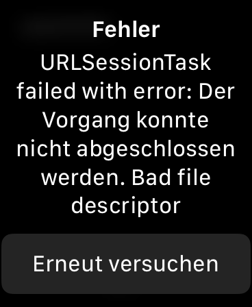

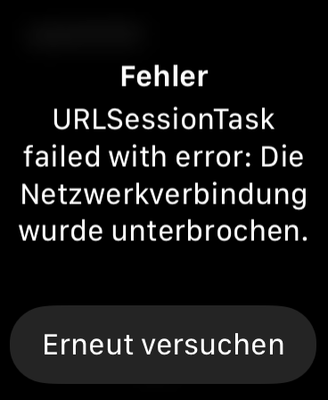

With the latest version on TestFlight (2.4.54) I get this error each time I start the watch app:

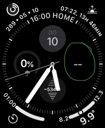

Since the latest version on Testflight the Watch complication no longer only displays the openHAB logo, but apparently a value should be displayed. For me, however, it is unfortunately unclear how to configure this value correctly so that there really appears something. Does anybody know something about this new feature?
Please post your settings here. Can only say that it is working for me.

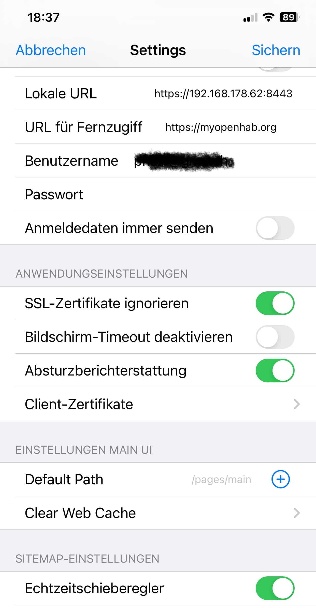

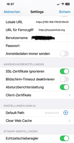

Thanks for your reply hmerk.
Below my settings. Before this settings I have also tried with the following values:
  • Local URL: http:192.168.178.62.8080 (instead of https://192.168.178.62.8443)
  • always send credentials: ON
  • ignore ssl certificate: OFF
I didn’t found any combination yet, which avoids all sort of error messages.
I think the sitemap should be ok, since all items work after confirming the erorr screen. The name of the sitemap file is “watch.sitemap” and the name is “watch”
App Version: 2.4.54 (1580410525)
OpenHAB Version: 3.2.0 - Release Build
Hmm, can‘t see any difference in the settings, apart from not using https locally.
Just tried, openHAB logo is shown on watch face and did not get your error message. There is a different error message when I open the app, but this one vanishes after a second or so without need of interaction.
Difference I see is that I am on openHAB 3.4.0.M3
Thanks for your reply. I think I will try it with an updated of openHAB in the next few days.
At least I can use the app after confirming the error message.
I have updated openHAB to the latest release version 3.3.0.
Now I still receive an error screen each time when I start the app on the watch, but the error message is a littel bit different:
