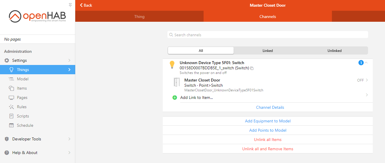

Discovers with just one Switch channel

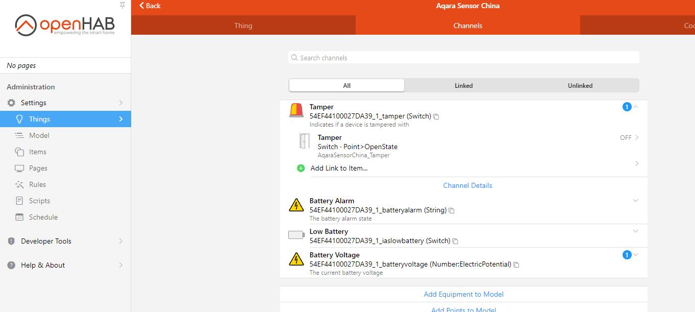

The sensor from Banggood is online but not working

The Amazon sensor (No model) has only one Switch channel.

The Banggood sensor (Model E1) has 4 different channels

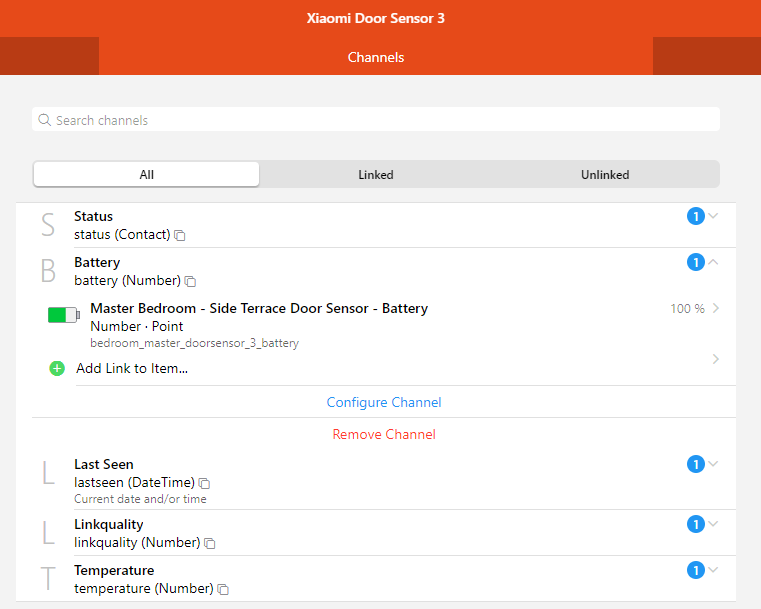

I got multiple sensors running (MCCGQ01LM and MCCGQ11LM) and they show up just fine in z2mqtt as coordinator as well as then in OH:
Your sensor sounds more like it is the Aqara T1 MCCGQ12LM which only gives contact/battery/voltage/link quality though.

@chris , any thoughts on why I only get a single Switch channel and @chrismast coordinator has a Status(Contact) channel as well as a Battery channel and others?

Not really. I don’t know these devices, and it seems that there are a few different ones. The binding will try to detect what the device supports - this normally works well for zigbee devices that follow the standards, but these cheap Chinese devices don’t.
We can create a manual thing definition that can fix some issues with non-standard devices, and this is done quite a lot for these devices, but not this one at the moment.
The Zigbee binding will never add channels to the coordinator. @chrismast is using mgtt so they presumably manage channels differently, but conceptually adding channels to the coordinator doesn’t make any sense.
Likewise some channels I see above like link quality are not added as channels by the binding - they are properties - different bindings will simply do different things.
Again though I simply don’t know what this device does and probably they are not following the standards when reporting the door sensor state so the binding can’t detect this channel (that’s my guess anyway).
