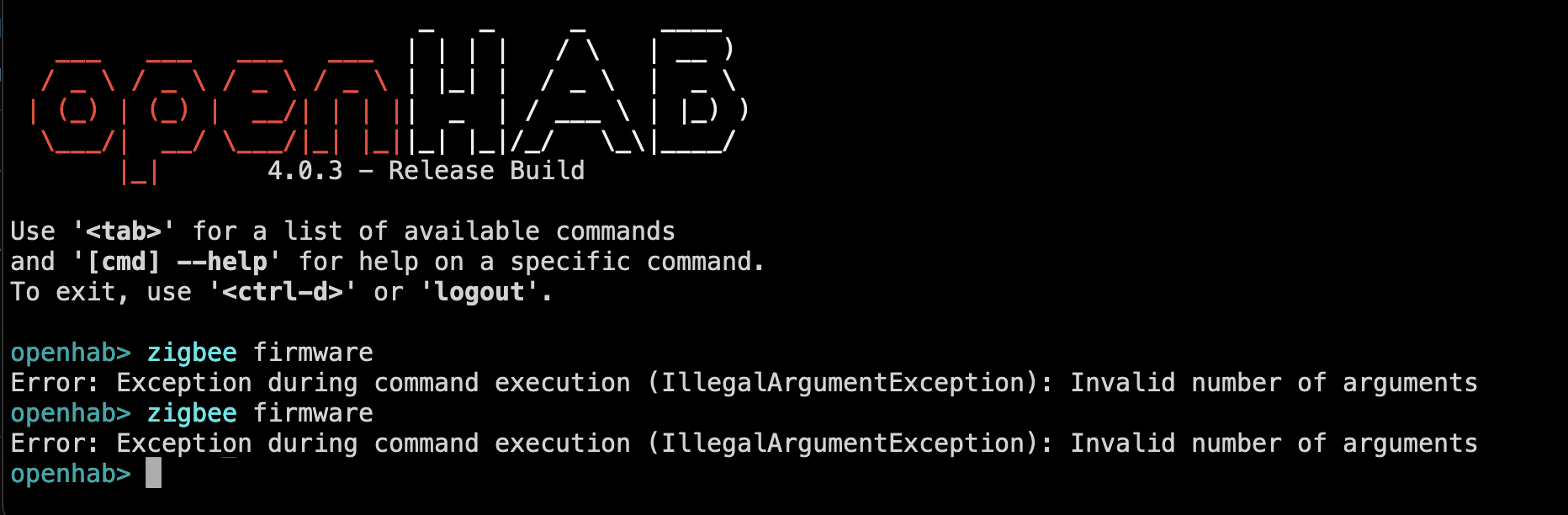

OK, I was able to log into the openhab console, but when I enter the zigbee firmware command I get an error message.
Am I missing something?

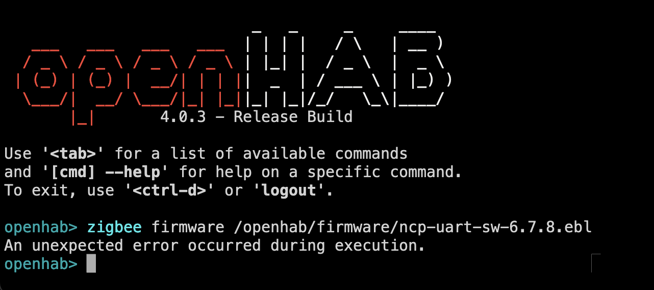

Hi @smitopher @chris I downloaded the file ncp-uart-sw-6.7.8.ebl which, according to the walthowd/husbzb-firmware github page, should be the latest zigbee controller firmware to use.
Can you please tell me where I should save the firmware file to use later with the binding upgrade method?
I’m using openhab as a docker app on unraid. I’m able to run the openhab console, but I’m not sure how to proceed from here.
You map the folder with the firmware to a folder in the docker container file system. This is a complicated discussion that depends upon how you define and run your container
Or you copy the file into your container. Also a complicated discussion
Try googling this
Thank you :folded_hands:
I tried mapping the docker app to a folder with the firmware file, and it seems the firmware upgrade starts (as the zigbee coordinator goes offline), but then the process fails with an error.
Any ideas why?
