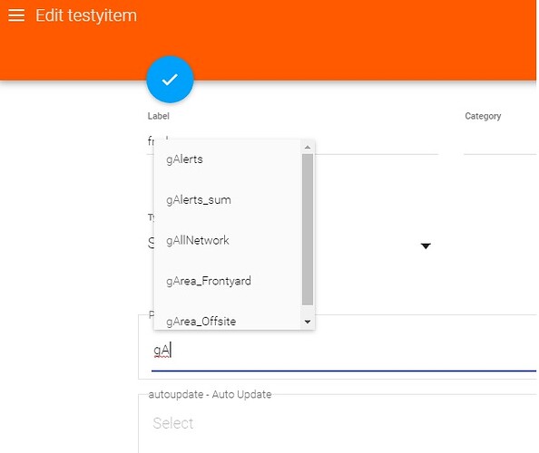

Works for me
PaperUI > Configuration > Items > yourItem, click pencil
click in Parent Groups box, pops up a list to select from.

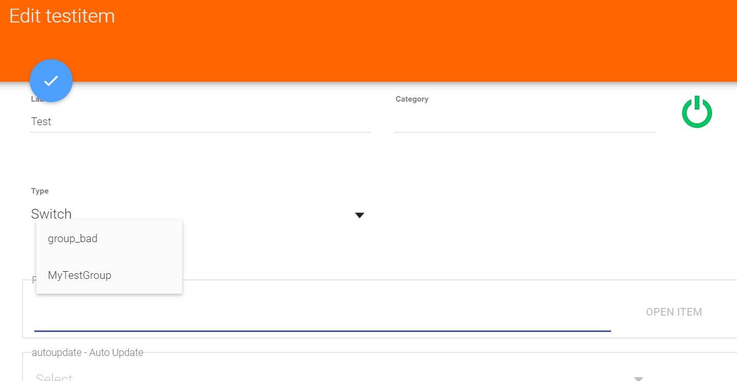

Sorry for confusing. I am aware of the differences, however i am not able to insert any groups into the respective field. It behaves like greyed out.
rossko57
(Rossko57)
May 12, 2020, 5:56pm
7
Neither can I. It provides a pop-up list when clicked on.
EDIT -I’ll take that back, can type in while list is displayed and auto-whittled down

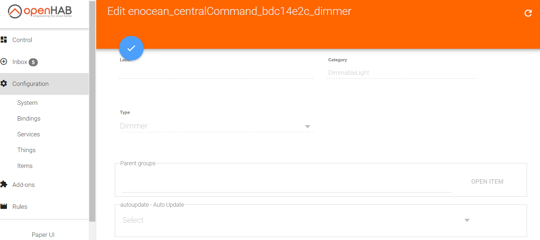

(Patrick)
May 12, 2020, 6:39pm
12
Please see one of my enocean actuators.
EDIT: as soon as i create an item nanually, i can add grou to it:
So it 's probably connected to @MDAR ’s post
rossko57
(Rossko57)
May 12, 2020, 6:44pm
13
That Item name looks like an auto-created Item.
