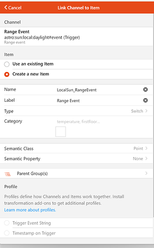

I was hoping to use the Astro Binding Local Sun Thing channel Daylight / Range event to switch the DaylightHours switch item. I was encouraged when I tried to Link a new item to the channel in the UI and the default Type was switch. But when I try to Link an item (new or existing) to the channel, I get an error “There is no profile available for the selected item.”
Here is what the Link channel to item screen looks like:
There are two profiles listed, but they are not clickable. It seems like what I need is a profile that uses the START and END triggers to turn the switch item ON and OFF.
I feel like I’m missing something, but perhaps it is not intended to work the way that I want it to.

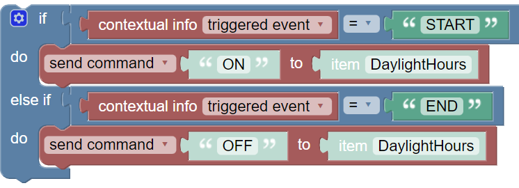

If this doesn’t work, then I will use a single rule to replace the two textual rules:

Blockly image:

You cannot link an Event Channel to an item. That’s kind of the whole point of them. Event Channels represent ephemeral events with no state. Items represent a state.
Thanks for the reply. I didn’t appreciate the important distinction between trigger channels and other types of channels. Your comment led me to Confusion between channels and channel triggers and its links that underscore the difference between and Event Channel and other channels.
