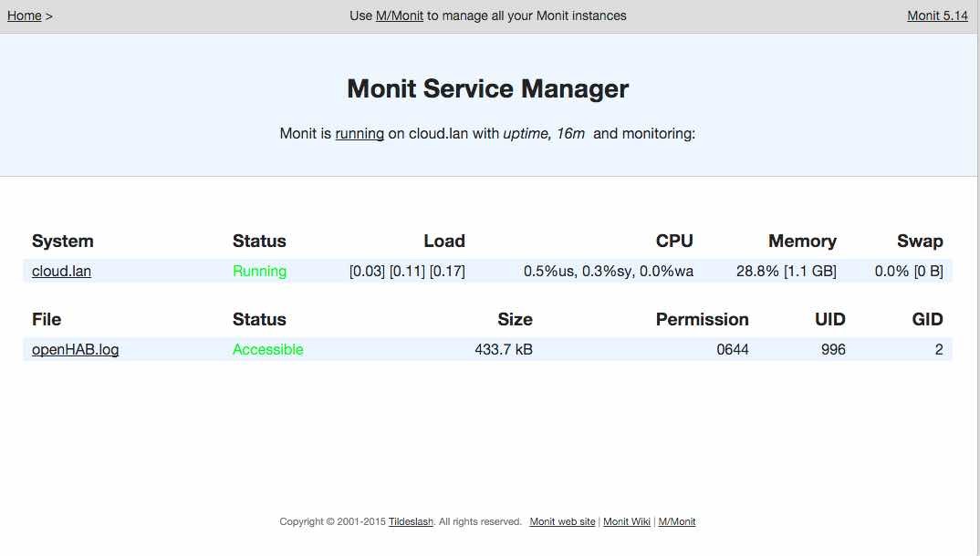

So I decided to use monit to monitor if the openhab log file still grows. If it stops being updated, I monit sends an alert and a three minutes later reboots the virtual machine, which so far was the only cure for lost USB connection.
Monit config that does it: check file openHAB.log with path /opt/openhab/logs/openhab.log if timestamp > 2 minutes then alert if timestamp > 5 minutes then exec "/usr/sbin/reboot"
For this single task it would be an overkill (even if it takes 3 minutes to install and setup), but yes, it is very useful to keep things up and running. You can easily monitor resources, services, processes, files etc and execute automated responses.

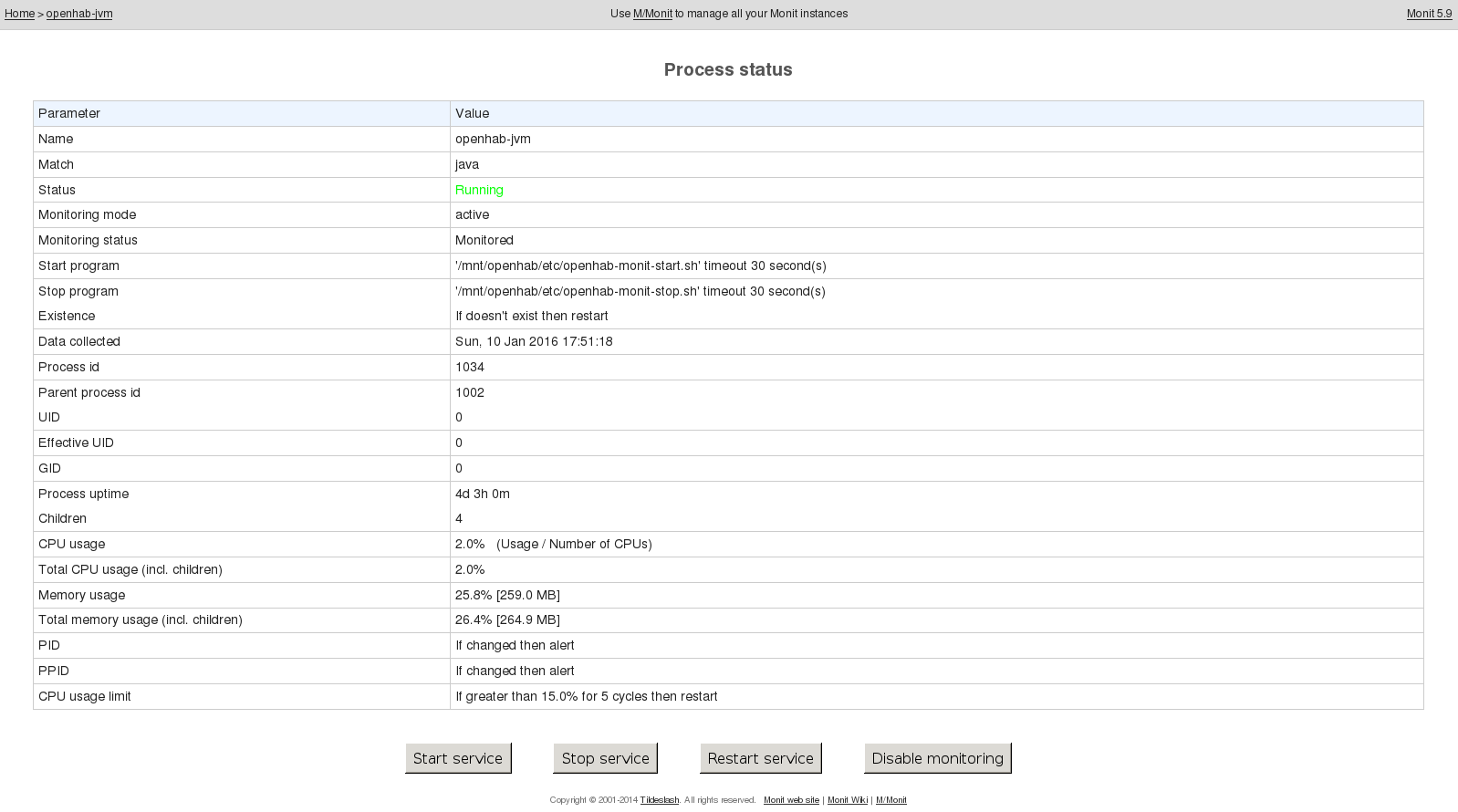

Yep, there’s nothing like JMX for getting some of the under-the-hood information on the OpenHAB JVM, but there’s nothing like Monit to kick it when it misbehaves!
