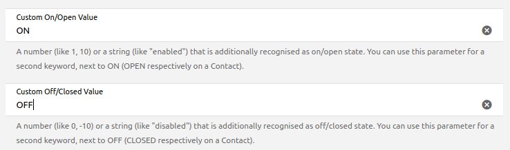

Try this in your Switch Channel configuration:
Or at least delete the 1 and 0 which seem to appear there by default.
Actually, I tried with your suggested way but no sucess. And I cant delete 1 and 0 if I focus out the value returns. Strange now color picker is working which is more complex but switch which is simple is stillnot updating th state if done from different app like alexa. Any thought
