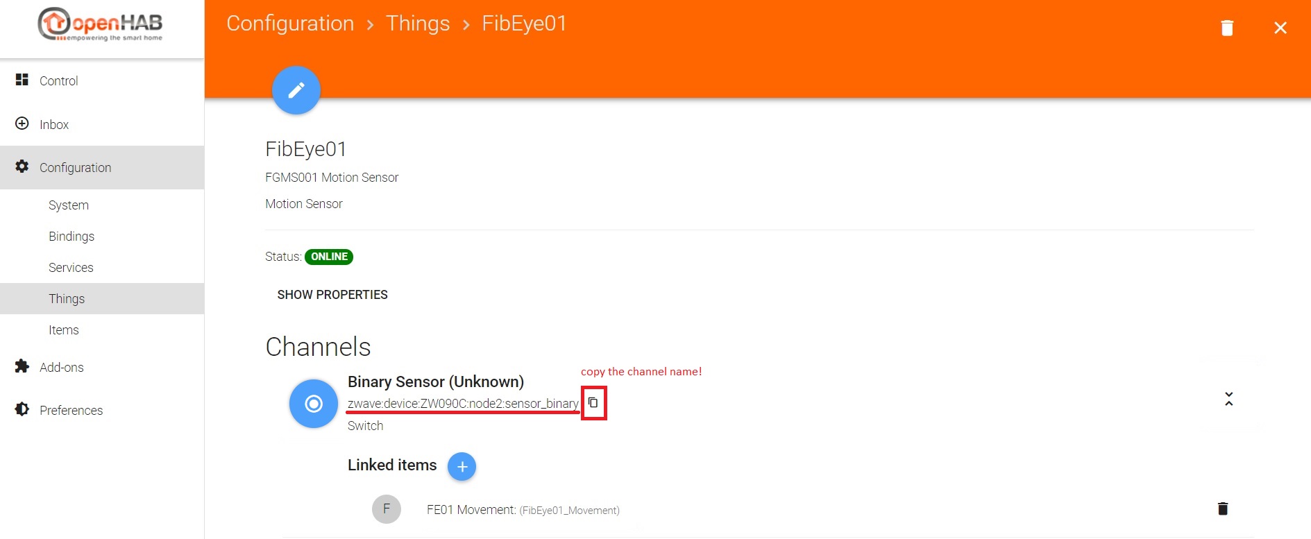

To manually define your items, you can use the following example (for the FGMS-001):
Number	FibEye01_Movement	"FE01 Movement: [%s]"			<present>		(gZWave)	{channel="zwave:device:ZW090C:node2:sensor_binary"}
Number	FibEye01_Alarm		"FE01 Alarm: [%s]"				<fire>			(gZWave)	{channel="zwave:device:ZW090C:node2:alarm_general"}
Number	FibEye01_Lux		"FE01 Lux: [%.2f Lux]"			<sun>			(gZWave)	{channel="zwave:device:ZW090C:node2:sensor_luminance"}
Number	FibEye01_Bat		"FE01 Battery: [%d %%]"			<battery>		(gZWave)	{channel="zwave:device:ZW090C:node2:battery-level"}
Number	FibEye01_Temp		"FE01 Temperature: [%.2f °C]"	<temperature>	(gZWave)	{channel="zwave:device:ZW090C:node2:sensor_temperature"}
Number	FibEye02_Movement	"FE02 Movement: [%s]"			<present>		(gZWave)	{channel="zwave:device:ZW090C:node3:sensor_binary"}
Number	FibEye02_Alarm		"FE02 Alarm: [%s]"				<fire>			(gZWave)	{channel="zwave:device:ZW090C:node3:alarm_general"}
Number	FibEye02_Lux		"FE02 Lux: [%.2f Lux]"			<sun>			(gZWave)	{channel="zwave:device:ZW090C:node3:sensor_luminance"}
Number	FibEye02_Bat		"FE02 Battery: [%d %%]"			<battery>		(gZWave)	{channel="zwave:device:ZW090C:node3:battery-level"}
Number	FibEye02_Temp		"FE02 Temperature: [%.2f °C]"	<temperature>	(gZWave)	{channel="zwave:device:ZW090C:node3:sensor_temperature"}
Note: Change the channel="" stuff with the info that you get from your system
(PaperUI → Configuration → Things → Edit the FibEye Thing → copy the channel name!)
