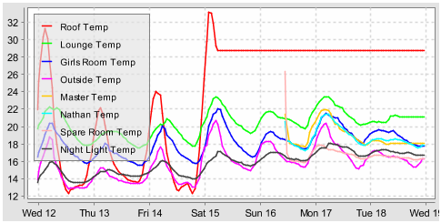

Can anyone think if a loop like this could be used to identify any item that has NOT been updated in the last hour and notify me?
I have a bunch of sensors that should be reporting to openhab at least every 60 minutes and so I want to know if one or more have not been updated…
I’m using the expire binding for that, add a expire="60m" to your channel definition, then the item state gets UNDEF if there has not been an update, then trigger a rule on UNDEF to send a notification.
Thanks I will take a look at that approach…
Here you can see my roof temp sensor has stopped working a few days ago and so it’s this situation that I am hoping to get notified about.
That is exactly how am I using that.
I’ve installed the Expire binding and am adding it to some sensors now… However this still feels like I have to write a rule per item I want to check? Is there any way to check all items in a group and report any that have not communicated for an hour?
