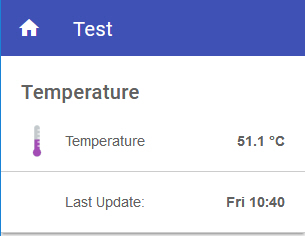

and also it is showing on webpage, but it is not showing any last update on webpage.

but nothing works at all. All I can see is - - on webpage beside Last Update

2018-01-12 10:40:32.761 [vent.ItemStateChangedEvent] - outdoor_temperature changed from NULL to 51.1
2018-01-12 10:40:32.775 [vent.ItemStateChangedEvent] - outdoor_sensor_LastUpdate changed from NULL to 2018-01-12T10:40:32.763+0100
