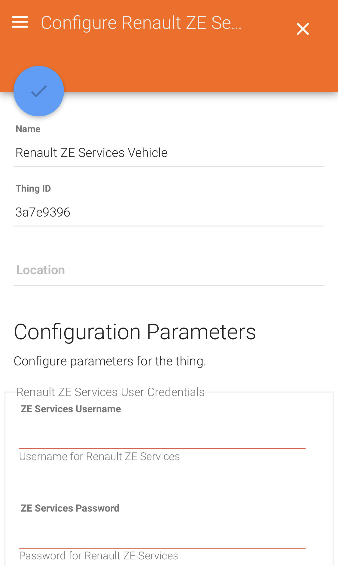

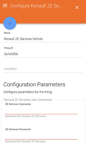

there is no inbox entry by default. As there is no device which can send a “I’m here message” you have to add the renault ze services thing by hand. To do so in Paper UI go to inbox and press the + Button in the left upper corner (I’m currenty not yet allowed to send pictures so I have to describe). You then will see the list of your intalled bindings. If everything is correct, You should see the “Renault Z.E. Services Binding” which you have to choose by clicking the small arrow on the rigtht side. You will get a new screen on which you have to choose " Renault ZE Services Vehicle" again by clicking on the small arrow on the right. After that you get the configuration screen where you have to fill out your Renault ZE Services credentials. Thats it.

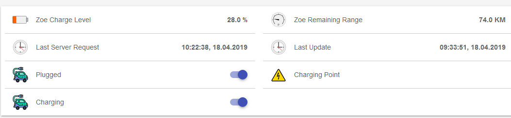

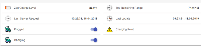

Here is the promised screenshot:

  • The logfile shows an entry like
    “Renault ZE Services Vehicle Token expiration date : 2019-04-18T10:22:29”
    every 5 min (on every update). This fills the log somehow. Could you remove it in a future version?
  • The “Plugged” and “Charging” Channels are shown as switches. Are they really writable??? Otherwise I would keep the items as switch, but show them as text in the sitemap.
I am really happy with the binding. Thanks for the great work.
Thanks for the positive commitment. Yes you are right, it shows up the in log every 5 Minutes the token message. It was for me to debug. I will make them optional in the next release.
“Plugged” and “Charging” are really switches, but only readable, so you can’t change them. So it makes sense to show them in the sitemap as text.
