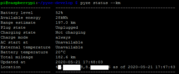

Just to give you also a screenshot of the phyton response:
Meanwhile I did a workaround. I added curl to the pyhton script and put the values via REST into openHab.
If somebody is interested, I can share later the appropriate code.
However. A binding would be more “nice”…
