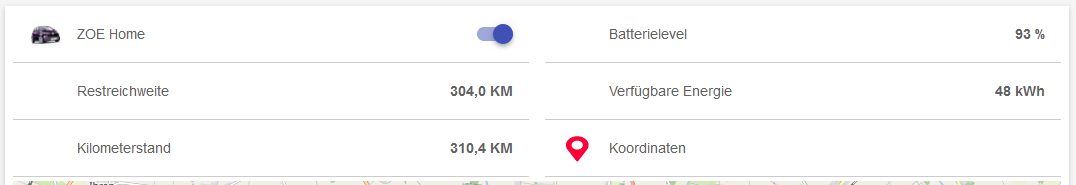

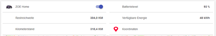

If somebody is interested, I added several rules like follows:
var Boolean MessageB = false
rule "RenaultZEService_Zoe_Refresh_server"
	Item RenaultZEServices_Zoe_Refresh received command ON or
   	Time cron "0 0/10 * * * ?" or
	System started
    val results_status = executeCommandLine("sudo -u pi /usr/local/bin/pyze status --km", 500000)
    logInfo("resultsStatus", "results_Status " + results_status)
    val results_vehicle = executeCommandLine("sudo -u pi /usr/local/bin/pyze vehicles", 500000)
    logInfo("resultsVehicle", "results_Vehicle " + results_vehicle)
   // with autoupdate=flase should not be necessary, but sometimes it stuck
   Thread::sleep(2)
    postUpdate(RenaultZEServices_Zoe_Refresh,OFF)
rule "Zoe Home"
    Item RenaultZEServices_Zoe_Location changed  or
	//Time cron "1 * * * * ?" or
	System started
    val PointType home_location  = new PointType(new DecimalType(48.xxx), new DecimalType(8.xxx))
    val PointType Zoe_location = RenaultZEServices_Zoe_Location.state as PointType
    val int distance = Zoe_location.distanceFrom(home_location).intValue()
    // specify your preferred radius (in meters)
    if ( distance < 50) {
        zoe_Home.postUpdate(ON)
    } else {
        zoe_Home.postUpdate(OFF)
rule "RenaultZEService_Zoe_send_broadcast_if_under_certain_limit"
	System started
 	if ((RenaultZEServices_Zoe_RemainingRange.state <= 100) && (MessageB == false) ){
        sendBroadcastNotification("Achtung! Restreichweite: " + RenaultZEServices_Zoe_RemainingRange.state +"km Ladestatus: " + RenaultZEServices_Zoe_ChargeLevel.state + "%"  )
        MessageB = true
     } else (RenaultZEServices_Zoe_RemainingRange.state >= 100){
           MessageB = false
The first rule simply update the items in either 10 minutes turnus or by using the refresh button.
The second rule is just showing if Zoe is in the garage or en route. (really just gadget)
The last one is sending a broadcast if the remaining range is below 100 km…
And finally I added a alexa rule:
rule "Alexa_Status_Zoe"
    Item RenaultZEServices_Zoe_Routine changed to ON
    Echo_Living_Room_TTS.sendCommand("Der Batteriestatus von der Zoe beträgt" + RenaultZEServices_Zoe_ChargeLevel.state + "Prozent und die Reichweite ist" + RenaultZEServices_Zoe_RemainingRange.state + "Kilometer.")
    RenaultZEServices_Zoe_Routine.sendCommand(OFF)
You have to create a item as follows:
Switch      RenaultZEServices_Zoe_Routine             "Routine"                [ "Switchable" ]
You have to add a routine in your Alexa app and simply switch the item.
Many gadgets, I know. But its nice to have:)

looks good.
Now, I would recommend to call the pyze script via crontab -e every minute…
BTW: I used following transform:
OFF=unterwegs
ON=Garage
NULL=unbekannt ?
UNDEF=unbekannt ?
-=unbekannt ?
and the item:
Switch      zoe_Home                                    "Zoe @Home [MAP(zoe.map):%s]"
Looks more nice;)
