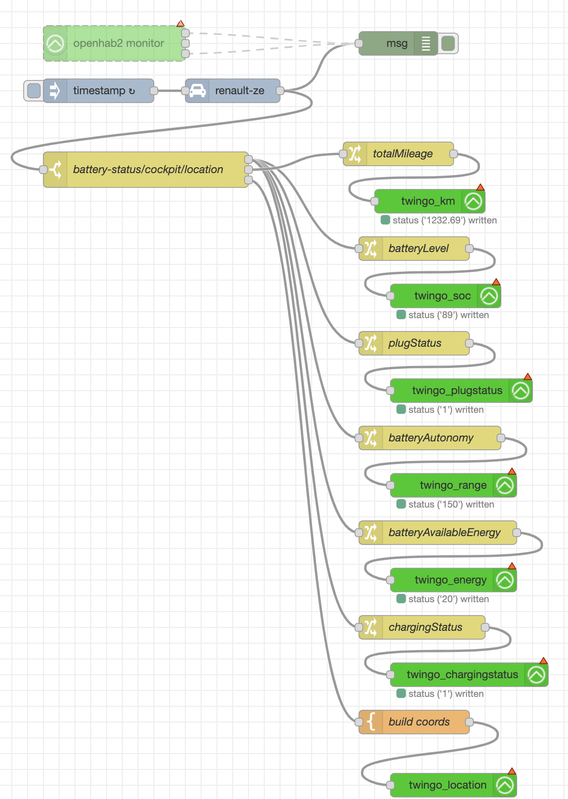

Wanted to share my solution, its way less effort, it uses nodered to query the my renault services every 3 minutes and update openhab items:
You can import this flow to node red, all you need to do is install the node-red-contrib-renault-ze package, setup your renault-ze credentials and insert the openhab token.
Should also work for zoe’s and other my renault cars, theres even more information in the messages, you can just add more outputs/transforms if wanted.
Note: I’m using node-red-contrib-openhab3 however the nodered functions are still called openhab2, but everything works as intended, it should be easily adaptable for openhab2.

        "id": "62a5c0e9f6b923f3",
        "type": "change",
        "z": "8df494c97fed8112",
        "name": "chargingStatus",
        "rules": [
                "t": "set",
                "p": "payload",
                "pt": "msg",
                "to": "payload.data.attributes.chargingStatus",
                "tot": "msg"
        "action": "",
        "property": "",
        "from": "",
        "to": "",
        "reg": false,
        "x": 540,
        "y": 1020,
        "wires": [
                "47086bb2243cd62a"
        "id": "47086bb2243cd62a",
        "type": "openhab2-out2",
        "name": "",
        "controller": "7cd34b3687b61c43",
        "itemname": "twingo_chargingstatus",
        "topic": "ItemUpdate",
        "payload": "",
        "onlywhenchanged": false,
        "x": 600,
        "y": 1080,
        "wires": []
        "id": "2f6420025ebc5f2c",
        "type": "openhab2-monitor2",
        "d": true,
        "name": "",
        "x": 170,
        "y": 140,
        "wires": [
                "c1370f4c30388dcc"
                "c1370f4c30388dcc"
        "id": "7cd34b3687b61c43",
        "type": "openhab2-controller2",
        "name": "",
        "protocol": "http",
        "host": "localhost",
        "port": "8080",
        "path": "",
        "username": "",
        "password": "",
        "ohversion": "v3",
        "token": ""

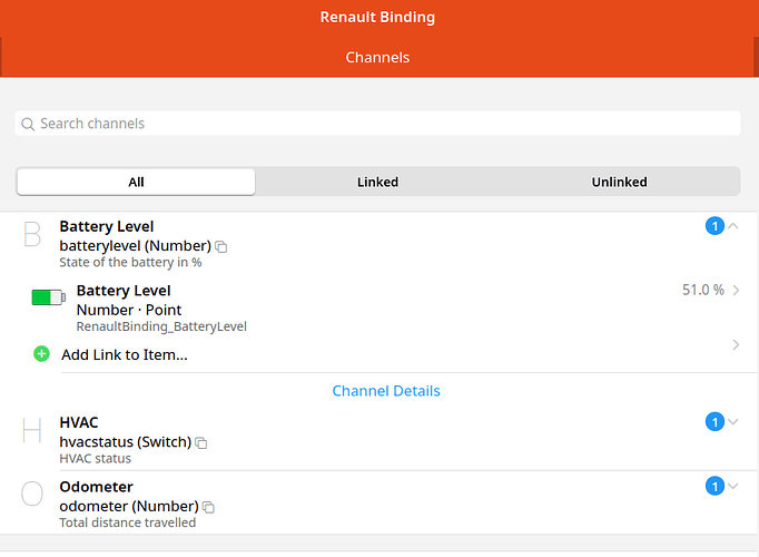

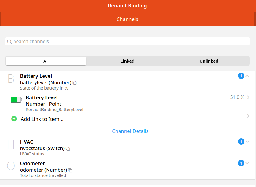

I have started to translate the python renault-api (Renault API — Renault API documentation) into an openhab binding (openhab-addons/bundles/org.openhab.binding.renault at renault · dougculnane/openhab-addons · GitHub). It is very basic (and read only at the moment) but if you want to test it please do.
It looks like it works with my computer and car…
