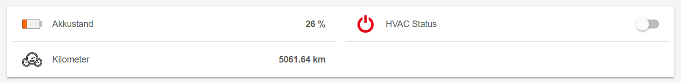

Hey there it was my failure. I didnt recognized that the manual installed binding is not seen under the bindings in the menu bar. I found the binding under things. Here it was easy to add an item for my ZOE. Now i will test the binding and give feedback.
Now all 3 items runing stabel. Good Job. TKS to all :+1:
