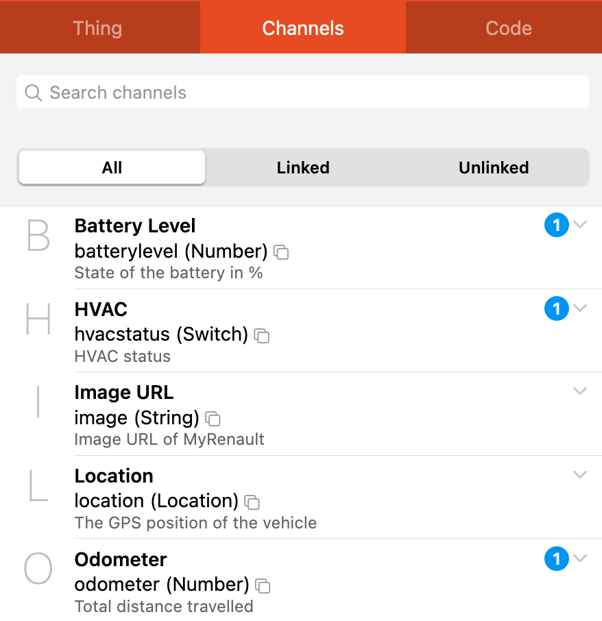

Now to the binding. It installed without problems. It provides the following channels:
Battery Level, HVAC and Odometer work as expected. The Image URL gives a URL to a weird icon and GPS does not work (this was expected). Thus, the binding is not able to access some information, available in the app. And although I do not use Location channel, I now get a regular error message
