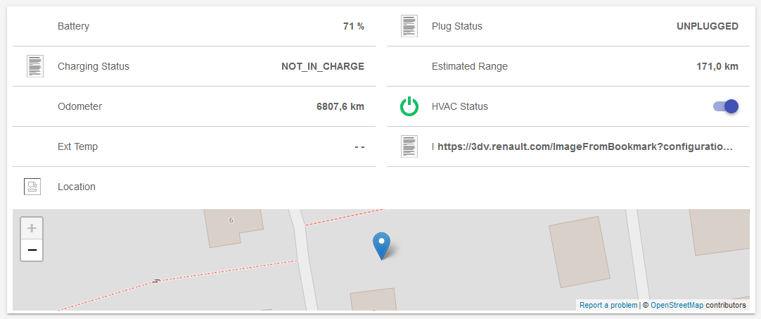

Finished.
All available channels get populated with the correct data (except of course external temperature).
ZOE R110/50 Experience 10/2020, openHAB 3.2 release version.
As the “HVAC Status” label implies I guess it is only possible to get the status of HVAC, but I cannot switch it ON through that channel?
Unfortunately I need that feature (HVAC is switched ON through iCalender Binding in my openHAB setup), so I will have to rely on my old script.
Thx for your ongoing work.

Here is an updated binding with more channels and HVAC switch now able to start pre-conditioning thanks to @sihui
https://drive.google.com/file/d/14onyNJA_TqYOQr0dYz6bPmChPioS4rS1/view?usp=sharing
You can set your target temperature using a channel value and switch on the HVAC. (The cancel (HVAC OFF /CANCEL) does not seam to work). If anyone has a working AC_OFF http example please let me know what it looks like.
There is a README.md here detailing the channels: openhab-addons/bundles/org.openhab.binding.renault at renault-more-channels · dougculnane/openhab-addons · GitHub
Please test and give me feedback. Not all channels work on my car but they might on yours?
