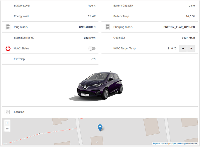

Is this useful?

Here are my findings from testing:
Battery Capacity does not populate, but it is not useful anyway from my point of view. Battery Energy Available is the better choice.
Battery Temperature is always fixed to 20 degrees, this was also the finding from the guy who wrote the php scripts.
External Temperature does not work on PH2.
So I think this was a successful test! Thank you very much.
I think I put you on a wrong track, it is the end of charging time, not the remaining time, sorry.
Edit: I was not yet able to turn the HVAC on through the switch. Will test later again.
All good, works :+1:

Unfortunately one important channel (for me) is missing, the status update time (in addtion to the location update time).
That timestamp is updated when for example a door is opened, the remote is used or if HVAC was activated. If the car is not in sight one can see if HVAC was successfully activated (without opening the Renault App which I don’t use at all).
But I don’t want to force you on anything :grinning:
For the not yet tested channels regarding charging I will come back to you …
