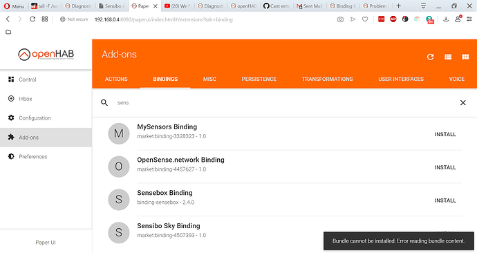

Hi All,
I have been using rules to interact with my Sensibo Sky unit these suddenly stopped functioning a few days ago after I would guess 18 months of near flawless activity.
I came across the fact that there is now a binding for Sensibo Sky so decided I would like to move across to the binding. unfortunately I am getting an issue trying to install it from PaperUI Addons section see the image below
ERROR:
Bundle cannot be installed: Error reading bundle content
I have not had this error previously when installing from the marketplace.
Reading through some of the posts in this thread it seemed I may need to install a bundle so I tried to see if that would improve my experience but unfortunately not.

Honestly I do not know what to do. I admit that I am not very expert… I tried to verify with Karaf if Gson is available and this is what I obtained:
openhab> bundle:list | grep Gson
212 │ Active   │  80 │ 2.8.2.v20180104-1110  │ Gson: Google Json Library for Java
272 │ Active   │  80 │ 2.8.5                 │ Gson
openhab>
Why I have two versions of Gson running? Is this maybe the origin of the mistake?
Thank you in advance for your help, Marco
Hi, is this thread still active? I downgraded to 2.4.0 stable, but I still have that error…
Any help is appreciated! Thanks! :slight_smile:
