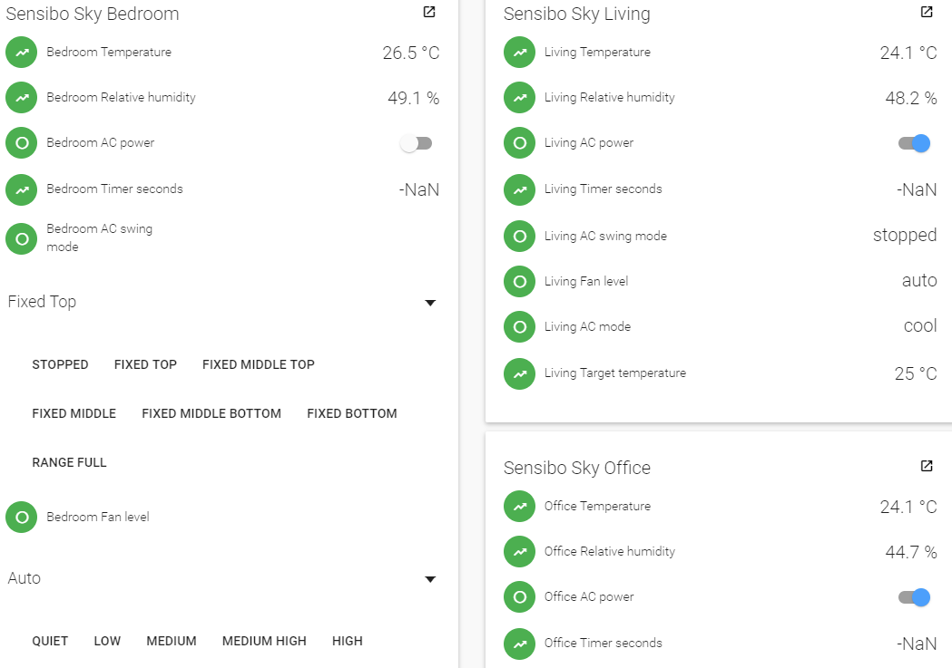

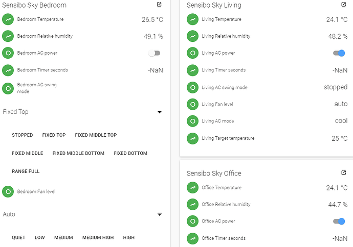

I just made an interesting observation regarding the selection item… 1 Pod is working absolutely fine whilst I am not able to do a selection in BasicUI for the other 2. So I went to Paper-UI Control and I can see:
So only Sensibo Sky Bedroom shows the selection whilst Office and Living don’t… Could it be a problem when having more than 1 device?

I did some changes to ensure that the channels are added every time the Sensibo sky comes back online. At least for now my the selections still show after about 20 hours runtime. The same goes for the sitemap items on my phone.
Feel free to give the new version a spin; https://github.com/seime/openhab2-addons/releases/download/2.5.9-SNAPSHOT/org.openhab.binding.sensibo-2.5.9-SNAPSHOT.jar
Be aware that simply adding the jar to the addons folder and disable the original bundle did not solve the issue; I had to remove the originally installed bundle fully - and then do a full restart of openhab.
