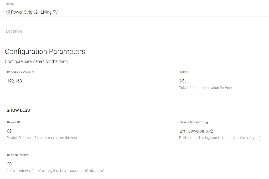

Here is my configuration-overview:
If there is any way I can give you more informations @marcel_verpaalen to add that device as known device just tell me what to do :slight_smile: Like power usage and so on.

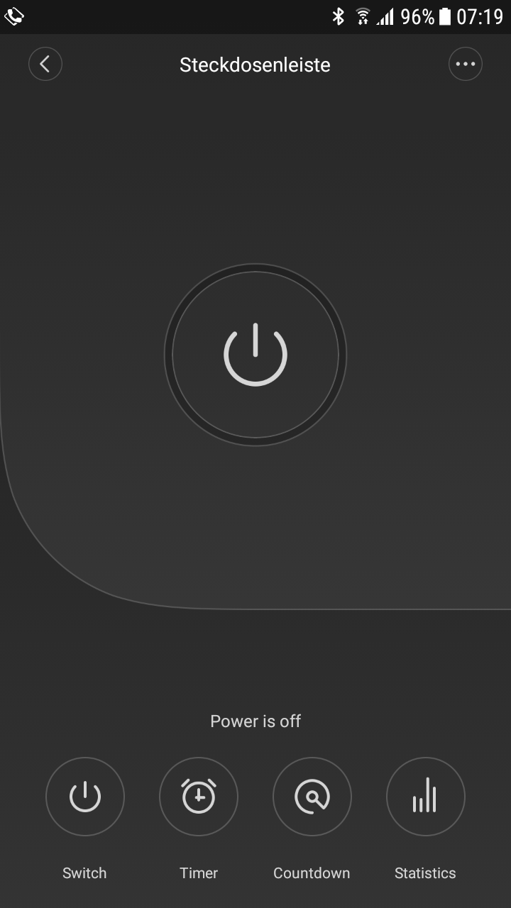

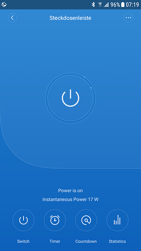

Here are already the screenshots:

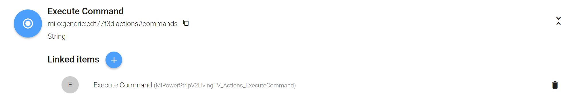

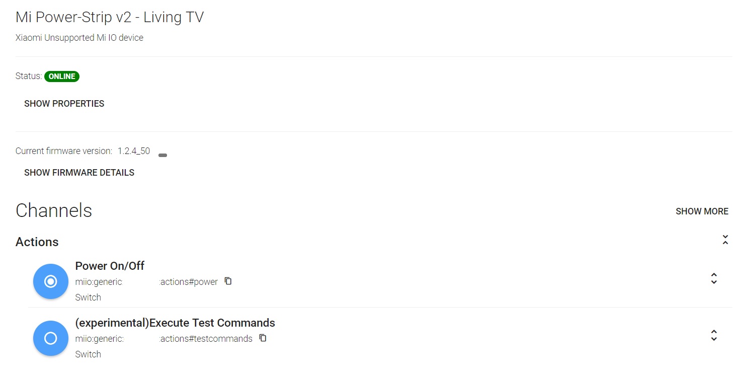

You go to your thing config. select the 'show more’to show the advanced channels
Enable the command channel.
Than you can update that channel with the command. Wait a bit and the channel is updated with the response.

It sounded easy, but guess it is not for me.
What I did is that:
After that I tried several commands like:
ā€œupdate MiPowerStripV2LivingTV-Actions_ExecuteCommand get_prop[ā€œcurrentā€]ā€
Also tried with bundle:update with things, item, channel and so on. Can you give me the exact command? Sorry to ask again…
Edit: Found something:
smarthome:update
I will try this.

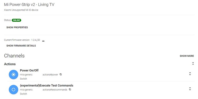

Edit 2:
How long do you need to wait? Nothing happens. Do I have to use the ā€œTest Commandā€-Channel?
ā€œ19:06:33.362 [INFO ] [marthome.event.ItemStateChangedEvent] - MiPowerStripV2LivingTV_Actions_ExecuteCommand changed from get_prop[temperature] to get_prop[current]ā€
