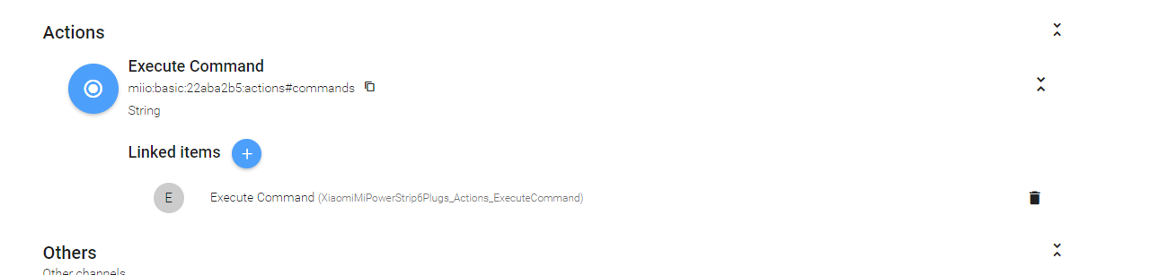

You can enable the command channel by going to paperUI, open your your thing.
Than when you see the list of channels, click on show all, and the enhanced channels can be selected. Enable the command channel (it is a advanced channel, so otherwise invisible)
You can than paste the commands there, wait a bit and the value of the channel will be updated with the response.
(I think in the vacuum thread there are some screenshots as well).

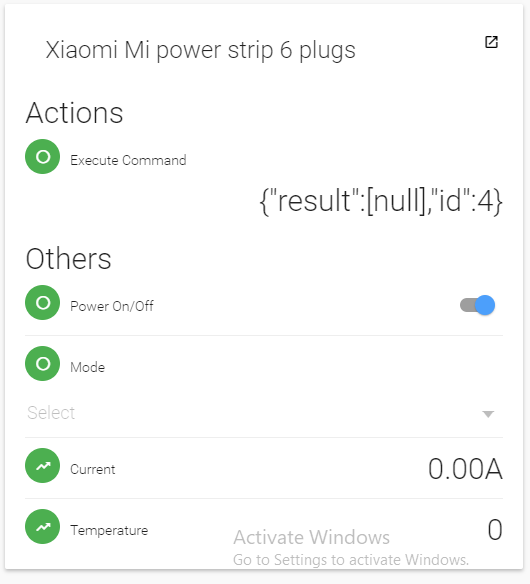

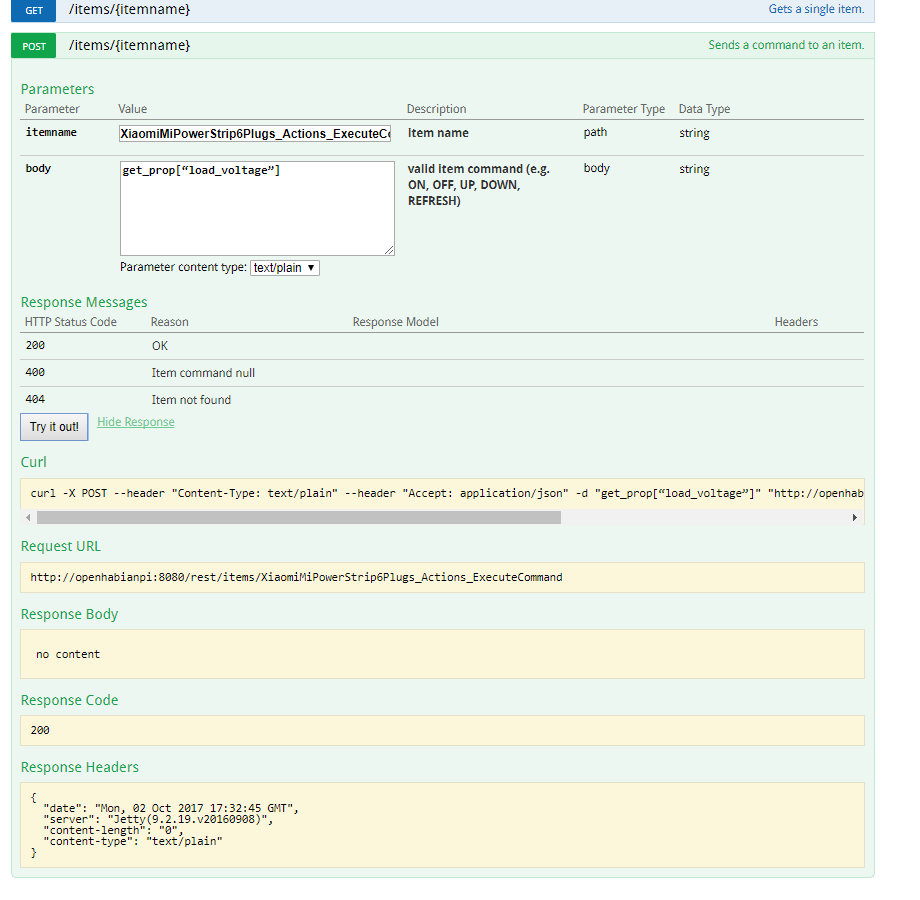

okay I tried to do it, I added a item for the executing command:
I send the get_prop[ā€œload_voltageā€] via REST API:

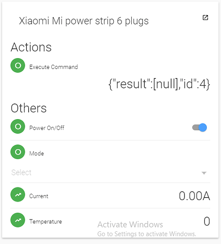

The result was a bit unexpected.
I think I did something worng :S
Nope, you did it right…
It means that property is not supported by your device. Can you try the other 2?
