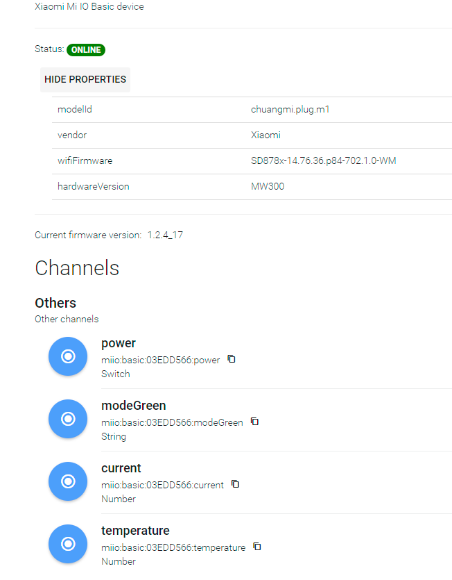

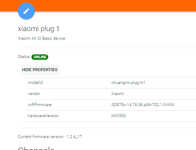

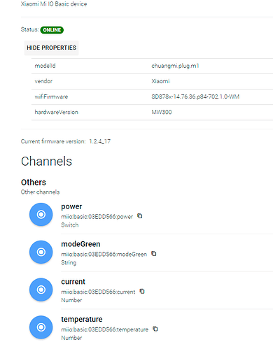

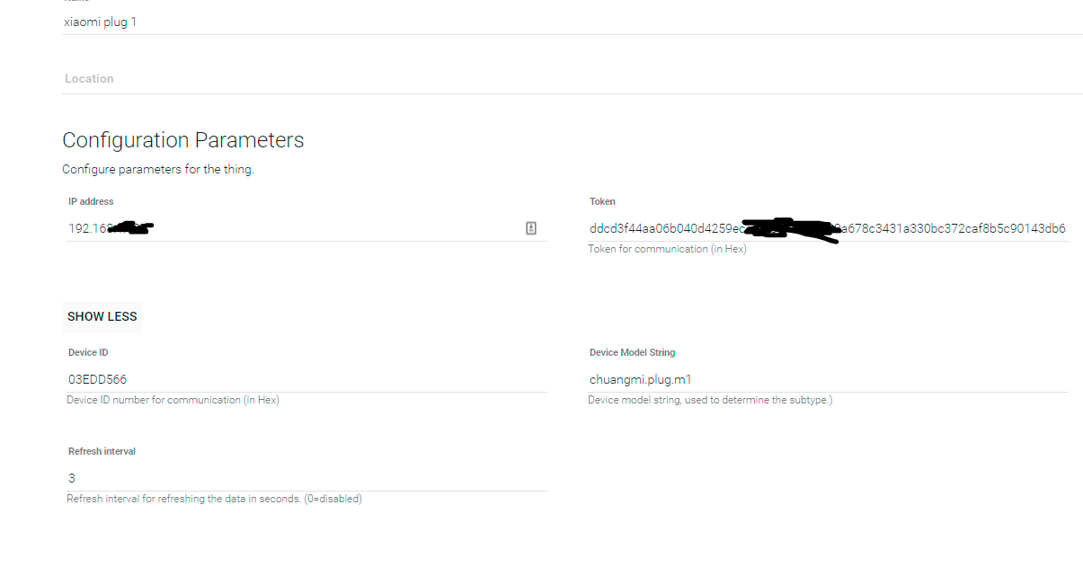

Okay, I tried it out, I had the same result, no responce, here is my definition of the thing:
btw. I notice I that I need to send a couple of on off cycles to the strip before I normally see it turn on or off. I don’t see anything strange in my log, tell me if I can send you some information on this to help.
The xiaomi power I’m testing is this one: https://www.aliexpress.com/item/New-App-Remote-Control-Original-Xiaomi-Smart-Power-Strip-Intelligent-6-Ports-WiFi-Wireless-Remote-Power/32810868837.html?spm=a2g0s.9042311.0.0.TeJGcA&aff_platform=aaf&cpt=1507017595061&sk=zj6qB6AIM&aff_trace_key=d71e01b7269647dabfed4f88f1b541f1-1507017595061-08758-zj6qB6AIM&terminal_id=e2b487dc2cd04ca28afdbbc22cfb565e
I have the latest binding which decodes the IOS token correctly and the thinkg shows up fine.

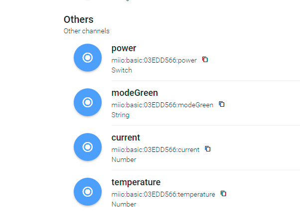

channels are bound to items:
item file:
Switch Xaiomi1  "Switch it on"  {channel="miio:basic:03EDD566:power" }
Number Xaiomi1current "Current " {channel="miio:basic:03EDD566:current"}
String Xaiomi1green "Green " {channel="miio:basic:03EDD566:modeGreen"}
Number Xaiomi1temp "Temp " {channel="miio:basic:03EDD566:temperature"}
sitemap
Switch item=Xaiomi1
Text item=Xaiomi1current
Text item=Xaiomi1green
Text item=Xaiomi1temp
Basic UI shows no values and switch does nothing:
Can anyone help?

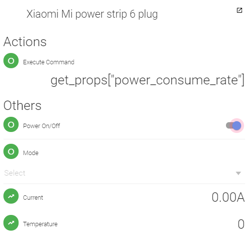

I tried the get_props[“power_consume_rate”]:
get_rt_power[1]:
Both are accepted by REST UI with responce 200 = OK
I will test the rest later when I have the chance
Normally after entering this, after a bit, the value is updated with the
response from your device.
Depends bit on how many commands are in the queue, but mostly this happens
in <10 sec.
This response is what I would like to know. The 200 response is something
internal from OH, not something your device is providing
I still see the last command after a couple of min. :
That’s indeed very odd.
What’s strange as well to me is that the mode & temp in your screenshot is not updated either.
Which would mean either the communication is not working fine or the screenupdate has a problem.
Can you share what is happening in the debug log when these commands are running, as that may give indication
