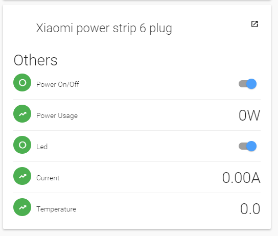

Hi Marcel
I tested the new binding, it works very good, with the power on and off. I didn’t notice any reading from the current and temperatur, but I’ll have to try it out a bit more, maybe I have to remove and add the item again, I’ll get back to you, but thanks so much for you work on the binding!’
I reinstalled the binding but I don’t get any values from the None-switch elemets, so the power on/off and the led switch works, but the rest I dont get any values.
