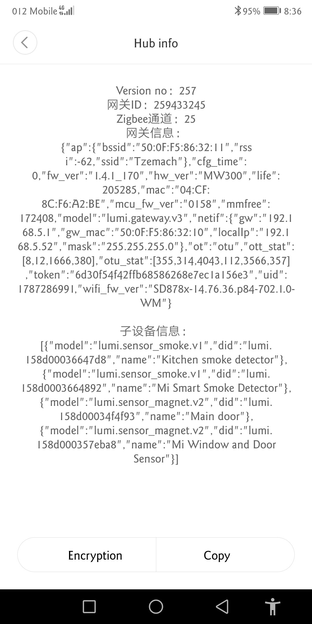

Attached the info of the getway.
Maybe there is compatiability issue with getway v3 and OH?

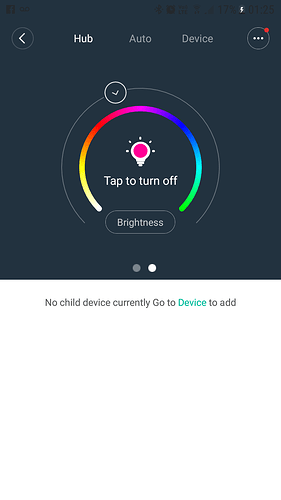

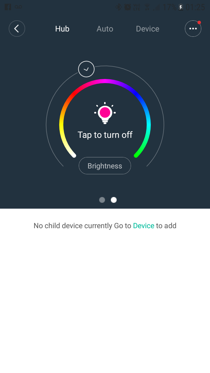

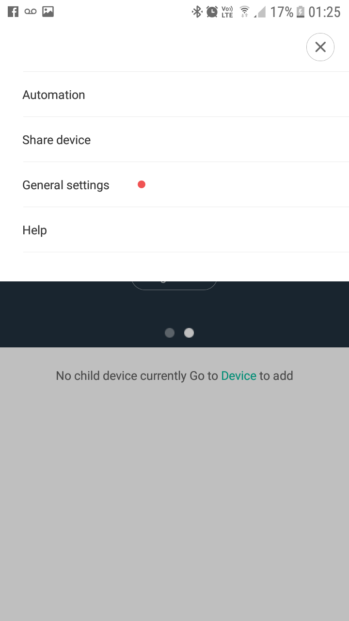

This is not the page described in the binding setup, the required page does have the switch to enable the WiFi functions and the developer key stated underneath.
When you go back on the page you showed above and go into the option before or after going into this page, then you should get the correct page with the WiFi functions switch and the developer key.

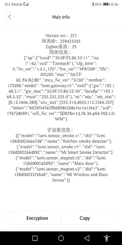

Hi
I attached the Hub info.. the other page you talked about is attached now.
What do you mean by " HomeKit enable version "

Yes, this is the correct page, with the wireless protocol turned on and the required developer key (aka password).
