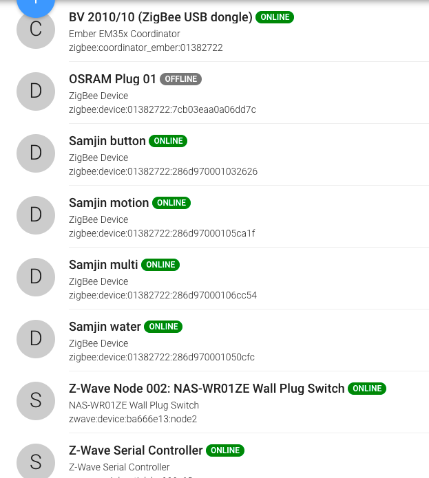

I reinstalled OH 2.4.0-1 in my RBPi and I’m adding all the devices that I had, so far jut Zigbee ones, it seems to be working for now.
And it happened again. Zigbee stopped working. Coincidentally I had just added the Zwave dongle and upgraded it to 2.5.0 (just the Zwave binding) so that my switch was identified.

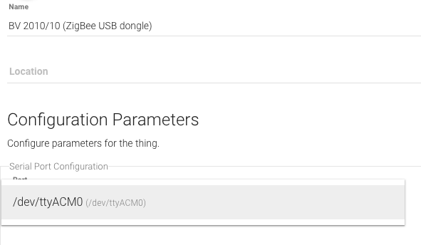

UPDATE: I just realised that the por is not selected in the parameters and the USB port doest not exist but I can see the device in linux shell… weird

Cannot add ZigBee dongle so I reboot. After reboot here you have the list of USB devices:
Openhabian@openHABianPi:~$ lsusb
Bus 001 Device 003: ID 0424:ec00 Standard Microsystems Corp. SMSC9512/9514 Fast Ethernet Adapter
Bus 001 Device 002: ID 0424:9514 Standard Microsystems Corp. SMC9514 Hub
Bus 001 Device 001: ID 1d6b:0002 Linux Foundation 2.0 root hub
Now I add the ZigBee dongle and it appears as Bus 001 Device 004: ID 10c4:8b34
Bus 001 Device 004: ID 10c4:8b34 Cygnal Integrated Products, Inc.
17:54 It shows up in PaperUI and I install it without problem
17:58 I start adding ZigBee devices
  • 4 Samjin devices
  • 1 Osram Plug
18:11 Channels for all of them created, seems to be working fine
18:15 I see events updating the temperarture every minute or so, I test the osram plug and it seems to be working as well
18:18 I remove channels that either do not report data or are redundant

18:23 I add the serial controller /dev/ttyACM0
18:24 A device quickly appears, I guess that it is because it was already paired with the stick
18:27 Device added and channels created (NAS-WR01ZE Wall Plug Switch)
18:28 It works, I can change the Switch to ON and get readings. System is responsive, reacts fast.
18:59:54 Something goes wrong
2019-08-11 18:59:54.493 [hingStatusInfoChangedEvent] - 'zigbee:coordinator_ember:01382722' changed from ONLINE to OFFLINE (COMMUNICATION_ERROR)
2019-08-11 18:59:54.505 [hingStatusInfoChangedEvent] - 'zigbee:device:01382722:286d970001032626' changed from ONLINE to OFFLINE (BRIDGE_OFFLINE)
2019-08-11 18:59:54.516 [hingStatusInfoChangedEvent] - 'zigbee:device:01382722:286d97000105ca1f' changed from ONLINE to OFFLINE (BRIDGE_OFFLINE)
2019-08-11 18:59:54.526 [hingStatusInfoChangedEvent] - 'zigbee:device:01382722:286d970001050cfc' changed from ONLINE to OFFLINE (BRIDGE_OFFLINE)
2019-08-11 18:59:54.533 [hingStatusInfoChangedEvent] - 'zigbee:device:01382722:286d97000106cc54' changed from ONLINE to OFFLINE (BRIDGE_OFFLINE)
2019-08-11 18:59:54.538 [hingStatusInfoChangedEvent] - 'zigbee:device:01382722:7cb03eaa0a06dd7c' changed from ONLINE to OFFLINE (BRIDGE_OFFLINE)
2019-08-11 18:59:56.497 [hingStatusInfoChangedEvent] - 'zigbee:coordinator_ember:01382722' changed from OFFLINE (COMMUNICATION_ERROR) to OFFLINE: Failed to open communications port
