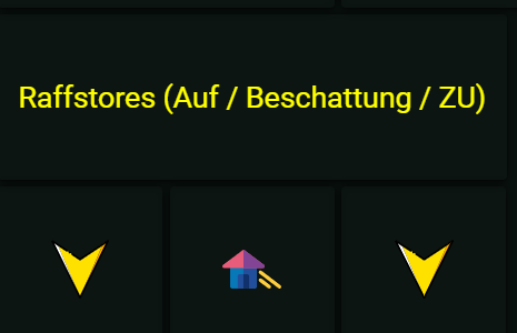

I have following usecase for the blinds. A Widget with 3 buttons.
[UP] [Home] [DOWN)
UP = blind up to 0%
DOWN = blind down to 100%
they are straight forward but
Home = Blind down but open a little bit - maybe like down to 100%, wait for finishing this and afterwards up again for about 3%?
or is there another way?
So 2 topics here:
1.: Can someone share his implementation to reach this? Rules or is there another way?
2.: Does someone has a nice widget as I am too bad in html/css coding :frowning:
This is my current implementation: Maybe this could be bind in one Widget instead of 4 items in dashboard :smiley:

Finally i managed it that it runs :wink: Thanks all for your help!!
Now it looks so easy when its running :wink:

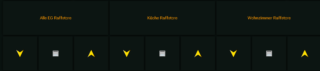

If someone having a similar request, this is my solution:
i have just each a button for “down”, “home” (meaning open the slat), and “up”.
When pressing “home”, the blinds must go down and about for about 2% again.
Items:
I created a group for each group of raffstores - here you see the Raffstore from groundfloor (gRaffstoresEG). Additionally one for the positioning control (gRaffstoresPosEG). And for sure the 2 items for my shelly.
Switch vRaffEGHOME "raff home"
Group:Rollershutter gRaffstoresEG
Group:Dimmer gRaffstoresPosEG
Rollershutter RaffstoreEZ "RaffstoreEZ" (gRaffstoresEG) {channel="shelly:shelly25-roller:xxxx:roller#control"}
Dimmer RaffstoreEZPos "RaffstoreEZPos" (gRaffstoresPosEG) {channel="shelly:shelly25-roller:e4e2dd:roller#rollerpos"}
For up and down my buttons just send 100 or 0 to the group. this is going to send command to all the items. done.
For the “home” part, a dummy item “vRaffEGHome” is switched to “ON”. Then I check if every blind is either down or already at 98% and just switch it to this percentage. If its any other value, i have first to move them to closed (100%).
And the last rule is triggering on positionchange, so for the shellys just once after its done. Here i just have to check if the virtual switch for “home” is on, otherwise i just might want to close it. So when its on, and the blind reached 0 (meaning 100%closed) i move them back up to 2% (meaning 98%closed)
Rules:
rule "to go up or down"
when Item gRaffstoresEG received command
    vRaffEGHOME.sendCommand(OFF)
    gRaffstoresEG.members.forEach[ i | i.sendCommand(receivedCommand) ]
rule "to go home position"
when Item vRaffEGHOME received command ON
    if(i.state == 100 || i.state == 98)
        i.sendCommand(98)}
    else
        i.sendCommand(100)
rule "set homeposition"
when Member of gRaffstoresPosEG changed
    if(triggeringItem.state == 0 && vRaffEGHOME.state == ON)
        triggeringItem.sendCommand(2)
The code might not be perfect for sure, but it looks quite ok for me and my current learning curve in openhab.
however, I might need to check if I really need the “positioningItem” or if i can also use the control item of the shelly - I think i had some problems before when trying with that item.
And another point might be that i have also other groups of venetian blinds and i would have to copy paste all of them. So another change might be useful to avoid copy pasting for all of my further groups (but anyhow there will be onls 3-4 groups at the end…)
If you see any issue or something completely wrong/to improve, please let me know;)
