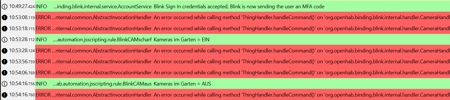

Thank you @dashrb for fixing the problem. I could implement the new addon.
Here is my log:
It seems to work but I have some error messages, one of them in detail:

    An error occurred while calling method ‘ThingHandler.handleCommand()’ on ‘org.openhab.binding.blink.internal.handler.CameraHandler@18869dfe’: Cannot call motion detection api without account or camera
  • Stack Trace
    java.lang.IllegalArgumentException: Cannot call motion detection api without account or camera
    at org.openhab.binding.blink.internal.service.CameraService.motionDetection(CameraService.java:52)
    at org.openhab.binding.blink.internal.handler.CameraHandler.handleCommand(CameraHandler.java:104)
