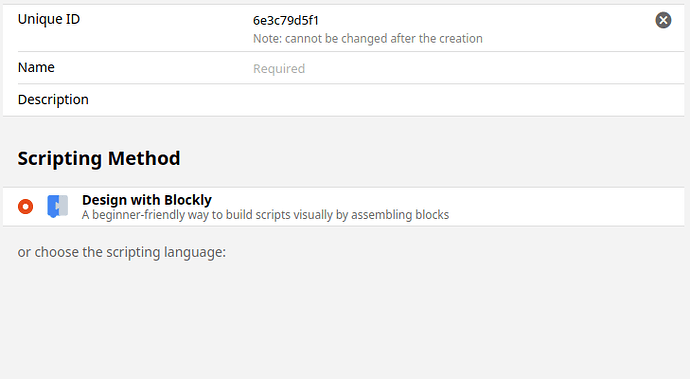

Sorry, I should have described the problem in more detail.

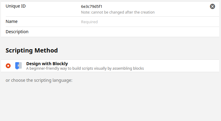

When I’m on the Scripts page, I press the “+” button and get to the Create script page. On it, under Scripting Method, I only see the line “Design with Blockly”. After the line “or choose the scripting language:” there is nothing else.
When I click on the line “Design with Blockly” nothing happens at all - no error pops up, no new window opens. I stay on the same Create script page.
I have checked with different browsers (Vivaldi and Firefox).

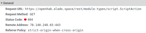

UPD: Now I’ve noticed that when the Create Script page is loaded, the developer console shows an error like this:
This may have something to do with the problem, but I don’t know what to do about it.
