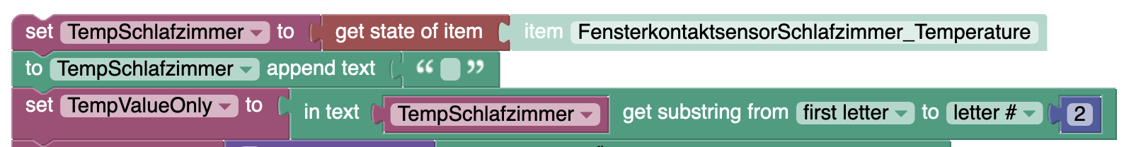

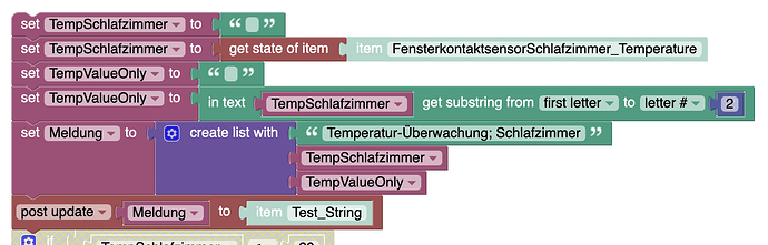

This is what I have so far. I initiate “TempSchlafzimmer” empty first, then get the Temp reading. It will be “17 °C” e.g.
Then I initiate “TempValueOnly” empty first, then try to slice the first two letters to it. This line gives me the error:
2022-03-19 23:20:19.315 [ERROR] [internal.handler.ScriptActionHandler] - Script execution of rule with UID ‘TempCheck_Fenstersensoren’ failed: TypeError: TempSchlafzimmer.slice is not a function in at line number 9
However, even if I can somehow manage to slice the temp value - both variables will be strings. How can I convert them to do maths with it? And why is this so complicated? Are there easier approaches to react on a certain measurement?

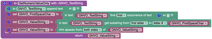

Just in case someone is stumbling across this post with a similar issue, here is how I solved it:
It’s a function block that you can call anywhere in the main program to convert. It takes the input value, looks for the first " " space character, stripes off all the rest and clears any probably remaining spaces before it returns the value back.
Thank you, @hafniumzinc!

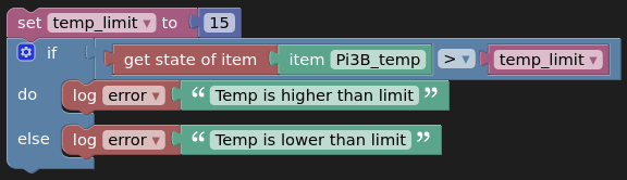

Blockly also seems to handle (at least) temperature quantities just fine for comparisons. For example, the following Number:Temperature Item:
  "link": "http://openhab.lan/rest/items/Pi3B_temp",
  "state": "32.71 °C",
  "stateDescription": {
    "step": 1,
    "pattern": "%s %unit%",
    "readOnly": true,
    "options": []
  "editable": true,
  "type": "Number:Temperature",
  "name": "Pi3B_temp",
  "label": "temp",
  "category": "",
  "tags": [
    "Point"
  "groupNames": []

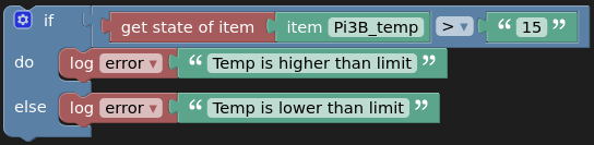

can be used succesfully as follows:
Generated code
var temp_limit;
temp_limit = 15;
if (itemRegistry.getItem('Pi3B_temp').getState() > temp_limit) {
  logger.error('Temp is higher than limit');
} else {
  logger.error('Temp is lower than limit');
or as follows (and suggested in the thread I linked in my first post):
Generated code
if (itemRegistry.getItem('Pi3B_temp').getState() > '15') {
} else {
So splitting the string shouldn’t be needed at all, I think @ItsaBastI.

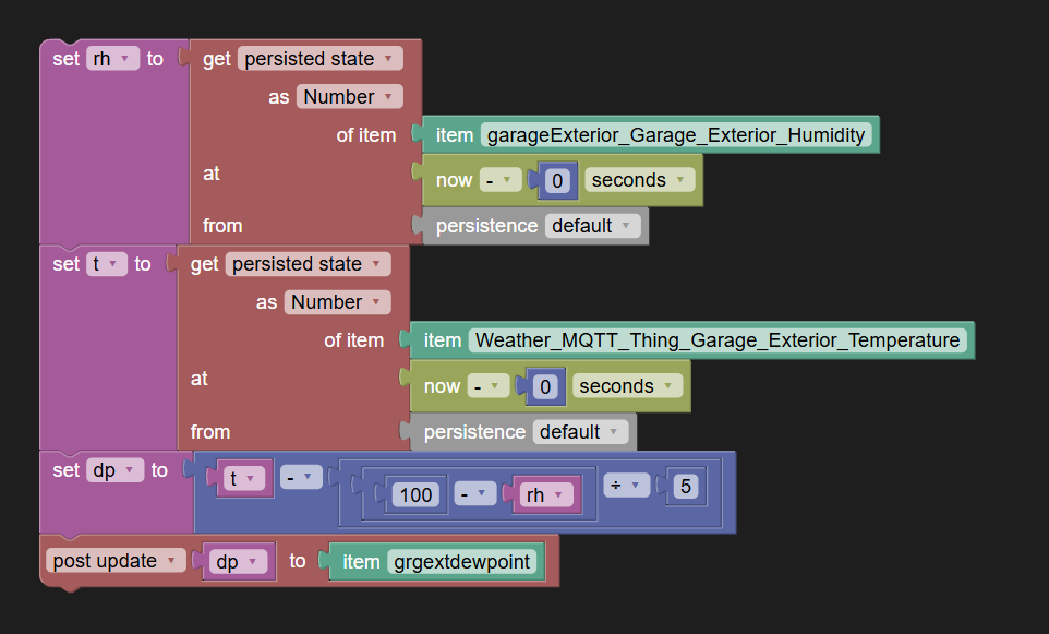

Here’s another option using persistence. This method allows direct extraction of numbers for use in math operations like dew point from temperature and relative humidity:
This is helpful. I’ve run into similar situations where an Item state includes a unit and it’s not immediately obvious whether the value needs to be converted first. The persistence approach looks useful for calculations, especially when working with temperature and humidity values. It’s nice to have a few options depending on the setup.
