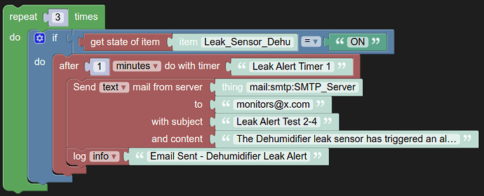

This is a rule I’m testing to repeat email alerts but I can’t seem to get the repeat function to work. If anyone can point me in the right direction I would appreciate it. I get just one email:

The only thing that I can see which might be a problem is if the “after 1 minute do with timer” block cancels the existing timer before creating a new one. You are trying to create three Timers but all three have the same name and even in 3.4 Blockly tries to generate code that cleans up after itself rather than leave stuff like orphaned timers hanging about. Seeing the code generated by the blocks will; confirm.
If this is the problem, you need to create a new name for the Timer each time through the loop.

There is an icon at the bottom right to show the code generated by the blocks. I don’t need the full rule’s code. But this works too.
OK, it’s not what I though was happening but it results in the same behavior. It only creates a new Timer if the old one doesn’t already exist or it exists but has terminated. So it creates the Timer named “Leak Alert Timer 1” on the first loop and skips the rest because a timer with that name already exists.
You need to use a unique name for the timers each time through the loop.
Also, even if three Timers are created, they are all going to go off at the same time. Do you really want to send three identical emails all at basically the same time? Wouldn’t it make more sense to spread the Timers out so you get one email perminute over the next three minutes?
Ah, didn’t know about the icon. Yes I want to send emails out on a timed basis. The final result will be a rule that sends an alert email every 30 minutes for 3 hrs., then backs down to every few hours until the leak sensor has cleared. Is there a way to do it without having to name a bunch of timers?
In OH 3.4, no. But keep in mind you can use a for loop block and get access to the i variable you can use to create the timer names.
